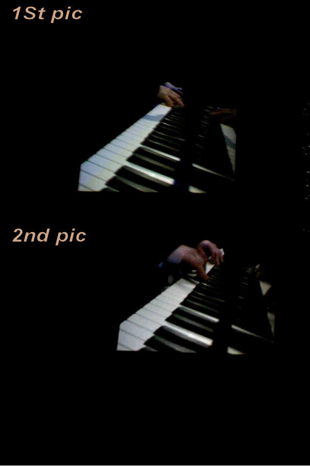

last night I went to a concert and I shot the big screen with my cam. The problem is that I had to hold the cam with the hand and the big screen moves everytime on the video. It was shot in a resolution of 640*480 but as I was far from the stage, the big screen just take half of the resolution. All around the big screen is black (take a look at the pic).
I'd like to recenter the big screen on the video, make it stop moving. Since everything is black all around, I think it is quite possible. I tryed the virtualdub filter "deshaker". It gives positive results by removing most of the trembling but I couldn't get it to re-center the screen.
That's what I am here asking your clever mind for some help.

 But you might try the Zwei-Stein Video Editor 3.01: http://www.tucows.com/preview/195042
 It has a lot better cropping/panning controls than VD. It's freeware, so you have little to lose. You might have to chop the video up to be able to apply the pan adjustments to the different parts of it. It accepts AVI, but I'm not sure about DV.

	Me again, in fact Deshacker does the job perfectly , I just didn't use it well before. Thanks !
