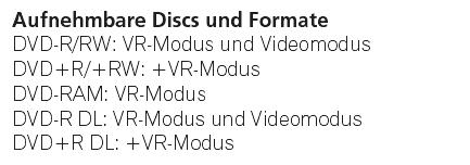

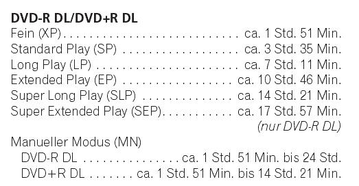

I cannot find an English language manual. How is your German?
and,
It is important to me. I only record to +DL these days. If it says it does, I am selling my 531H.
[edit]Maybe not. Does it say it records to dvd+r DL only in +vr mode? -
I did find the English version of the manual.
It can do dvd+r DL but only in +VR mode

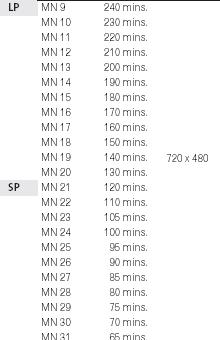

John will not like this, LP mode ( four hour ) is now 720 by 480.

The Pioneer DVR-531H-s does 720x480 up to the 210 minute recording mode ... the next mode is 220 minutes at which point it finally drops down to 352x480 ... whereas the drop from 720x480 to 352x480 should happen in the 140 - 160 minute range.
