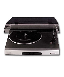

I have an old bush turntable which only cost about 20 pounds.
I record my vinyls to mp3 but i find with a lot of my rips they dont have enough bass and dont sound clear enough therefore some come out fine.
I was wondering if a turntable like a numark or stanton would be better at handling most types of vinyl and would be a better choice to go for?
I dont want to go spending all my money on a turntable to find out its not the turntable anyway.
I dont know if its a mixer.
Heres a link of the turntable i use to rip:
http://www.comparestoreprices.co.uk/images/bu/bush-mtt1-silver.jpg
Cheers people!

Your turntable should be fine. -

Does your mixer have a phono preamplifier built-in to it? If you're just going straight into line level jacks, you're not getting proper phono equalization curve. Otherwise, can't think of what the problem could be.
I recommend that you capture to a low (or no) compression wav format, then encode as a separate step. That way, if the mp3 encoding is unsatisfactory, you can change the settings without having to re-play the vinyl.
I also recommend that unless your turntable requires a phono input, you connect the turntable directly to the line-in on the PC. -
Just looked at the specs on your turntable and see it has built-in phono-preamp, so that's no the problem.
