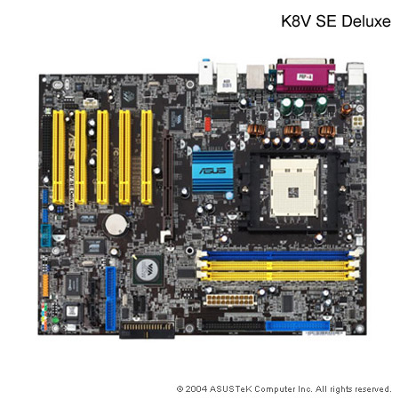

    I have an ASUS motherboard with SATA support, I installed one SATA HDD and tried to install windows using that configuration, and windows ask me for an IDE disk to write some data to it.
    Maybe my motherboard just does not allow one single SATA for booting an OS, there is the option of Bootrom chip enabled when in RAID mode.

    To be frank with you, I am not sure now, I had problems installing Windows XP to my new system consisting of just one SATA HDD, the only way to boot Windows was installing an IDE HDD. After that, the installation went alright and I was able to boot Windows using the SATA disk.
    According to my motherboard documentation, if I configure two SATAs as RAID, I need to enable the Bootrom chip. Maybe this could make a difference.
    P.S.
    My motherboard is the ASUS K8V SE Deluxe and in reference to storage is advertised:
    Dual SATA RAID
    The Promise 20378 RAID controller incorporated two Serial ATA and one parallel connectors with RAID 0, RAID 1 and RAID 0+1 functions while the VT8237 RAID controller provides another two Serial ATA connectors for RAID 0 and RAID 1 functions. The K8V SE Deluxe is the ideal solution to enhance hard disk performance and data backup protection without the cost of add-on cards.
    No tengo miedo a la muerte. Solo significa soņar en silencio. Un sueņo que perdura por siempre. ..

    I have exactly that same MB, and the only issue I ran into in building the system was that the MB (or BIOS, not sure which) wouldn't support a SATA optical drive as a boot device. Once I swapped in an IDE optical drive, no problems loading XP SP2 onto the WD SATA HDD (only had the 1 HDD to begin with).
    I do not use the RAID functionality, BTW. Each of the 2 HDDs are separate (one for OS & data, other for video processing only).
