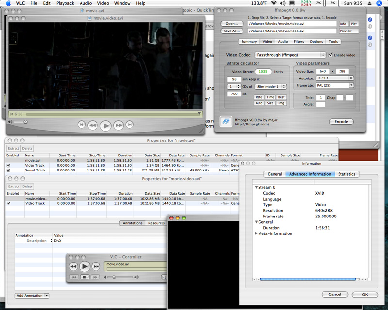

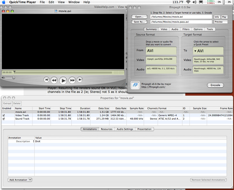

    5.1 Audio is supposed to work in the ffmpeg encoder and that's what I use. But there are even basic functions that haven't worked for me for a very long time. All my software is the latest and everything else works as it's supposed to.
    Let's start with something easy. An AVI that works great in everything.
    Do a simple Passthrough, Video and Audio. Here's what I get;
    Well, QT sees an Audio track but can't determine any info. The audio doesn't play and note the duration. It's a little confusing because the audio track data size is missing. If it were there though, it would be the difference between the video data size and about 1023MB. In all the tests, QT will only 'see' the first 1GB of the movie. Look at the video duration listed in ffmpegX, 83744 minutes. VLC, 2022:58:08. The audio doesn't play in VLC either.

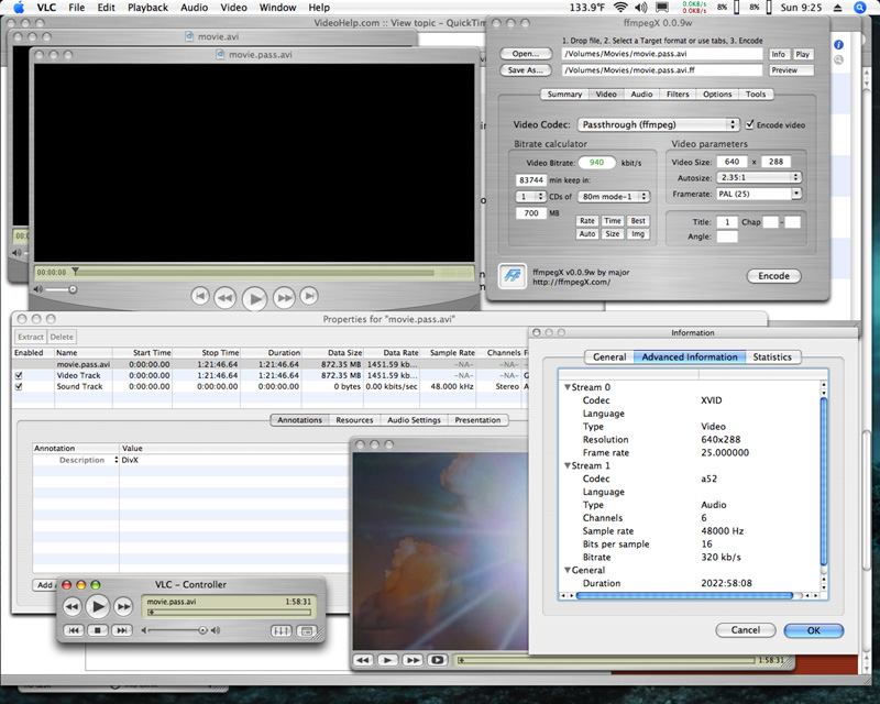

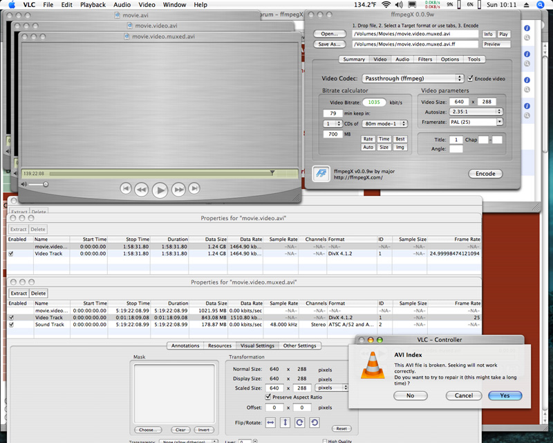

    Okay, next let's try using ffmpegX to Passthrough just the video;
    Again, QT only sees the first 1GB. But wait, ffmpegX only sees 98 minutes of video also. VLC however sees it all. Well, I need ffmpegX to see the entire video track so I use QT to delete the main movies audio track, then 'Save as AVI' on the video track. Now everything sees the entire video track. I use ffmpegX to Passthrough the 5.1 channel audio track and A.Pack is happy with it.
    Now we do a simple mux as .avi in the Tools section of ffmpegX;
    Oh my. What's that time listed in QT? 5:19:22:08.99. Does that mean 5 Days? No wonder the audio track won't play. Again, QT and ffmpegX agree on the video tracks duration simply cause they only see the first 1021.95MBs of the movie. Even VLC doesn't like it, believe me, you don't want to click that 'Yes' button. Click No and then VLC will play the Video but not the audio.

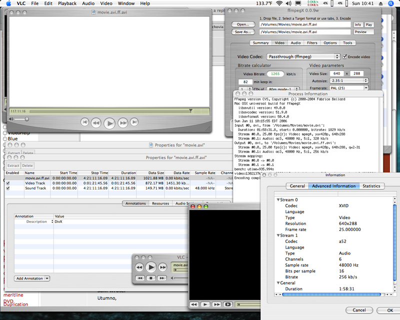

    OK, let's try running the original Movie in ffmpegX, we'll choose XviD ffmpeg, Passthrough the Video and choose 5.1 channel AC3 256kbs verses the original 320kbs. And we get;
    Well, at least QT says it's under 5 Days this time. The data size is still just under 1GB. VLC says it's fine but neither it nor QT will play the audio.
    This is busted right?

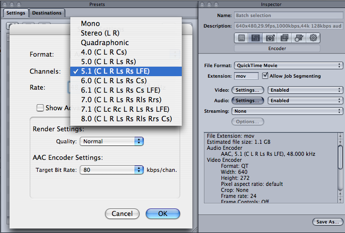

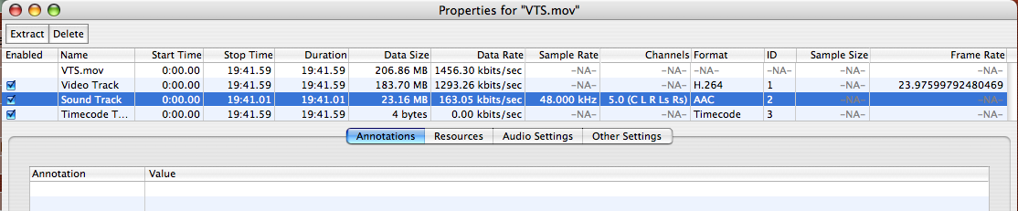

    I know that the current QT Player won't output 5.1 AC3, it's always going to be down-sampled to Stereo on playback. That's why it always lists it as stereo. VLC is pretty good, but most people I know use ffmpegX to determine the movies content.

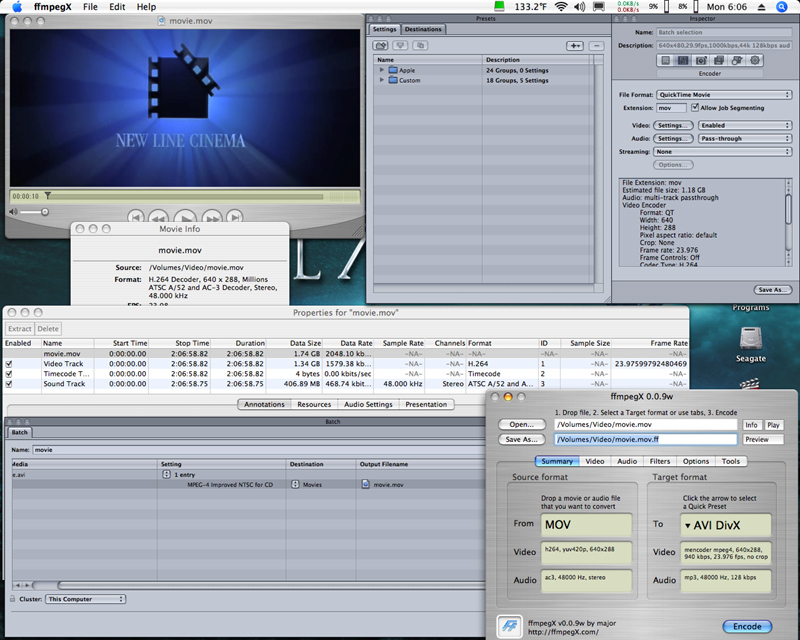

    Which brings up the picture below. I have never tried to make a MOV with AC3 before, mainly because the AC3 Component we had didn't support it. I had opened an AVI in the QT Player that had AC3, and done a 'Save As' before, and that Mov did work in QT with AC3 audio (it was always stereo though) but what is shown below is a first for me. Another reason was that my DviX Player doesn't do MOVs, it likes AVIs. Which is why I use ffmpegX.
    But, I've about had it with my current DviX Player model. I've now had two machines fail within 4 months. They are under warranty, but... A computer connected to the TV looks very good right now.
    So, I made an AC3 movie with Compressor 2 by choosing 'Passthrough' for audio. The original AVI had 5.1 audio and Compressor correctly identified it as 'multi-track passthrough' but the output appears to be stereo. VLC and ffmpegX both identify it as stereo but neither one of them will play the audio. QT Player and Toast play it fine, which means that any Core Audio App should also. Which is one benefit from the new AC3 decoder. A very nice benefit.
    Now I just need to know if anyone has a means to play a QT MOV on a 5.1 channel system (I don't have one at present) and see if it is indeed stereo. Compressor 2 will output 5.1 audio as it's Apples replacement for A.Pack. But will it do it in a MOV? And what would you use to play that MOV to realize 5.1 Audio?

    Hah. Silence. AC-3 doesn't playback correctly in QuickTime and VLC reports 6 channels whereas (working) HandBrake rips report 5 channels.
    Doesn't work on my KiSS DP-600 either. It may be that ffmpeg itself is just broken on this, and not ffmpegX !

    As for ffmpegX - for me the results with AC3 haven't been nearly as bad as for Tugboat. I'm using creating mencoder xvid .avis.
    Maybe because I'm using FfmpegX 0.0.9v?

    why (if I understand you) you want to re-encode an .avi but passthrough the .ac3 it already has? I must not understand.
    My DviX Player doesn't do Qpel. Any Qpel AVI I run across has to be re-encoded, preferably keeping the 5.1 unmolested.
    I challenge anyone to take a video track and an AC3 track, mux it with any version of ffmpegX, and have it work in QT.
    I might try the mencoder encode again but I've found that my Player doesn't like mencoder, it likes XviD ffmpeg. Although I am considering giving up the DviX Player for a Computer.
    Has anyone considered just giving up on AC3 and going with AAC 5.1? I'm converting an AVI right now just to see what happens. It's going to be awhile, I need a new Intel Mac Pro....

  30. Member
    Jan 2003
    Florida
    Try this.
    Right click on the ffmpegX App in the Applications folder and select, show package contents.
    Go to Contents/Resources.
    Open the terminal and drag the AVImerge app into the window.
    Type in something like this;
    -o VTS.avi -i /Volumes/Video/VTS_01_7.video.avi -p /Volumes/Video/VTS_01_7.ac3
    Hit return.
    QuickTime is happy. ffmpegX says 'ac3, 48000 Hz, 5:1, 448 kb/s'. But VLC says, Channels: 3 ??????? The question marks are mine.
    And this from someone with CLI phobia.
    I noticed that D-Vision is apparently using AVImerge to MUX.
    ffmpegX is apparently using ffmpeg2 to MUX.
    I just noticed that even though the ffmpegX Summary window says 5:1, if you hit the Info button it says chans = 3. So, I'm still not sure if this is fully working.
    I also found that the version of AVImerge in D-Vision is different than the one in ffmpegX. The one in ffmpegX is larger. For those not satisfied with a CLI, it appears you can place the larger file into D-Vision and it will work just the same as from the CLI.
    Now... Anyone read French? I found a conversation about 5:1 in D-Vision but it doesn't translate well. I think it sums up this situation pretty well if I'm understanding it correctly, Someone Translate Please.
    The Compressor2 results look pretty good except I'm going to have to run it again. I'm certain I chose 5.1 but I got 5.0. This was using a VirtualDubMod AVI with 5.1 AC3, the video was 19:42 long and took 44 minutes to encode to MOV.
