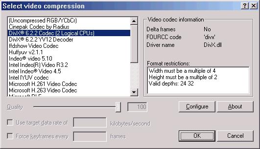

  7. If you installed Divx before the dual core processor you have the single threaded version. Where you select the codec in VirtualDUb you should see it labeled as "Divx 6.2 (2 logical CPUs)". With Xvid I have to manually enable 2 threads in the Xvid config dialogs.

  9. I removed the divx and rebooted then reinstalled and I now see the codec you mentioned.

  11. After reinstalling it works now and what a difference. Before it took 54 minutes to encode a 70 minute avi. After it recognized the 2 cpu's it 19 minutes to encode the same avi!
