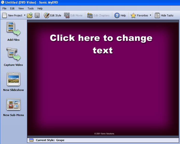

  12. I had version 5.2.2 before 6. These images are from version 6 but they are similar.
    First, you should have a screen similar to this one with a "capture video" icon,

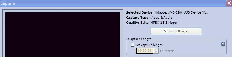

    Click on the "capture video" icon and a screen like that below should appear,
    Notice the box that says "Record Settings...". Click on it and select one of the mpeg-2 settings. In the image above "Better mpeg2 5.5 Mbs" is selected.

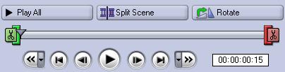

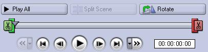

    it's either i trim off too much or too little. what i want to do is, trim it down to the second.. is this possible?
    Yes, the problem is MyDVD can trim to about 0.5 - 1.0 second accuracy but other editors can do it to 1/30th of a second which appears to be what you want. MyDVD is a bit deceptive.
    Here is part of the edit screen
    and the description of what the time code means,
    It sounds like you can cut to the specific frame but notice the the "Split Scene" button is grayed out until the 15th frame,
    so the cuts are GOP ( group of pictures ) level.
