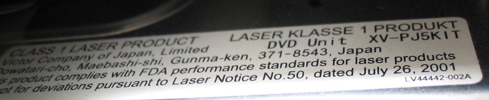

What I found so far was that there should be a JVC DVD player inside. If you detach the speaker covers you can see two screws that unhook the part with the display. Behind it you will see a serial number that says XV-PJ5KIT.
I could not open the rest of the machine without being afraid that I would damage anything. (I still have two screws left but its working) If there is anyone out there who has more info on the dvd player than please speak up.

Can you take picture of XV-PJ5KIT PCB with clear Chip model? I know some major IC supplier in Taiwan. Maybe they can help on this.

It did work for me! Here you will find pictures of the my Moviemate 25, just so you can compare model numbers, etc.
The procedure was easy:
1. Create the CD as described
2. Insert disk into the unit and wait. No visible feedback, just wait and after approx 2 min the unit will turn off and you will hear a couple of beeps.
3. Pop in a DVD from a different region and enjoy.
Kudos to whoever provided that hack! -

I was not confident at first as I could not find label on DVD player.
After a couple of months use I found that I could confirm the DVD player model was XVPJ5 by holding down power button and play button whist switching on projector until the screen showed Test JC1, then pressing the source button a couple of times to switch on bulb. The model details were then projected.
