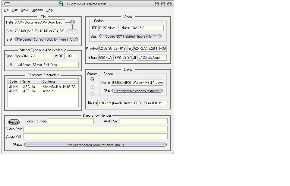

I have a video whose technical details is as follows:
Video Compression: Divx Codec (.avi)
Resolution: 624x272
Audio: 128Kbps (Lame MP3)
Total Video File Size: 700MB
Now I would like to make VCD so that I can view the movie (its a home video) in my standalone DVD player which unfortunately can not play DivX codec. I tried to use nero to write it as a VCD but the size is beyond the capacity of 1 disk. So how can I make VCD out of it?![]()
Moreover I am not sure whethere the video is PAL or NTSC but my player supports PAL only. If the file is in NTSC can it be converted to PAL?
I have downloaded Virtualdubmod and please find Gspot screenshot of the file enclosed.

The source file is indeed NTSC, but I wouldn't bother much about that, since most PAL players handle NTSC material nicely. (So you should aim for a NTSC VCD - Don't try to create a PAL VCD from a NTSC source file - that kind of stuff can get really nasty!)

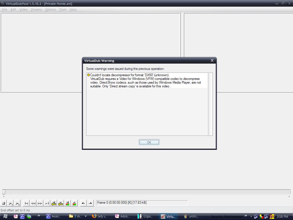

I used AVI2VCD decompressor to convert the main file's audio. Now I installed the hnadler of VD. As I tried to open the file it gave me an error massege (screenshot attached) irrespective of either trying to open the main file or the decompressed file. Now what I should do? Could you please explain?
Secondly the screenshot of VD provided in the tutorial shows a tab named "audio" which I could not find out when I ran my VD (please see the screenshot). Also I have some trouble in understanding pre step b and the following (mostly regarding applicability in my case). I would appreciate and be grateful to you if you could explain the method stepwise in a more rudimentary manner.

I think the guide uses VirtualDub, whereas you use VirtualDubMod?
Also, use the fourcc changer to change DX50 to DIVX in your source AVI - may help VD to load the AVI.
