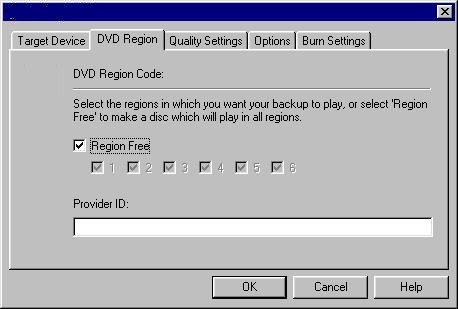

    Hi sawbo1:
    I also have a region-1-only standalone DVD player. When I used DVD Shrink, I always set the DVD region code as Region Free (see attached picture). All my discs play fine in my DVD player.

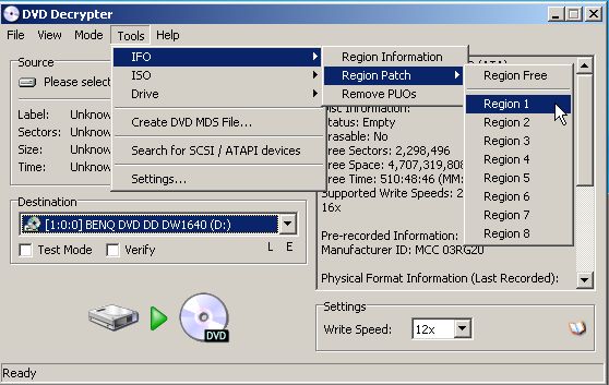

    Mount the dvdshrink created image under daemon tools, then use decrypter to patch back to region 1. I know its circuitous but it is simple to do.

    I used DVDFabDecrypter on one and set to region 1, it worked fine. But some movies are large and I need to shrink them too. If I use DVDShrink it will set to all regions automatically even if I select just region 1. That's what I'm finding anyway.
    Feb 2002
    Car DVD player? Oh, I think we are dealing with another kind of problem.
    My brother has a car DVD player. I made for him some DVDs which play fine in all of his standlone players. But his car player just refuses to play all of them.
