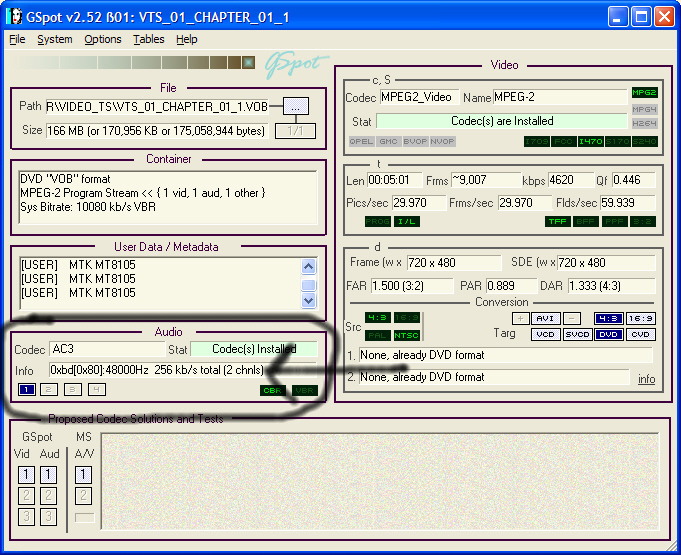

It appears my 1107 model does have a stereo rf tuner:
That was taken from a rip using dvddecrypter. The show was a syndicated repeat of Stargate this afternoon on our local fox affiliate (whom I'm positive broadcasts everything in stereo). I was using the internal tuner and not the vcr.Donatello - The Shredder? Michelangelo - Maybe all that hardware is for making coleslaw? -

I just wanted to point out that just because a RF tuner input recording shows up as 2 channel AC-3 does not mean the RF tuner is a STEREO tuner.
Even if the RF tuner input was mono the resulting AC-3 would still be 2 channel as that is "standard". I've only ever come across a few 1.0 AC-3 DVD discs and all were very early production DVD discs (from the early days of DVD Video). Just about all DVD discs with mono sound are still encoded as 2.0 AC-3 audio.

I couldn't quite get the widescreen recording to work right on the hdtv captures off my pc. However the letterboxed output looked just fine.
I recorded TOY STORY 2 tonight through my av input off of my stereo vcr. I used the vcr tuner and programed the dvd recorder to record it. Worked perfectly. It looks great recorded in SP 2 hour mode.
Now what I've done is ripped it to my pc using dvd decrypter. I set it to no chapters and no file splitting to give me one large vob. I opened the vob in mpg2cut2 and chopped out the commercials. I plopped the mpg into tda and I'm burning my new disc with chapter cuts and new menus (basic stuff nothing fancy).
I love this. Now if I had spent a little more and gotten a dvd recorder with a harddrive I could have done this editing on the unit itself but this isn't too much of a hassle. Just 10 or 20 minutes to rip the disc and another 10 or 20 minutes to chop the comercials and author the disc, plus time to burn the disc. But its pretty automated so not too much trouble to get it going.
Oh and by the way it DID record in stereo perfectly off of the vcr input jacks. So this will work out great. Though I'll only be doing stereo recording for movies and sci fi tv shows as its a bit of an extra hassle. But things like sitcoms, home improvement shows and news I don't need in stereo so I'll probably just record those with the mono internal tuner.
This unit is a really good dvd recorder and I love its dual format abiltiy to record + and - r discs. Saves the hassle of "commiting" to one or the other.
