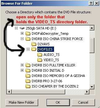

    i want to convert my video ts files to a image files using image tool classic but every time i try to use image tool classic it says it can't find the video_ts directory. when i click on the folder where i hold the movie files nothing shows i have them in a folder on the desktop and the folder is the movie name. but it show no vob or ifo file or no video_ts folders. what am i doing wrong? the animated guide looks like i am doing it right.
    man i have tried everything to get image tool classic to work are there any better guides on this program that that tells you how to convert, ifo, vob and video _ts files to image files? thanks
  9. DVD Ninja budz's Avatar
    Jan 2003
    In the shadows.....
    I did the same thing you did when I first used IMGTOOL CLASSIC. When you direct IMGTOOL CLASSIC to find the VIDEO_TS directory don't open up the actual VIDEO_TS directory. Just direct it to the folder that has the VIDEO_TS directory folder. Look at this screenshot below. I only opened up the folder that contains the VIDEO_TS directory.
    image tool classic works great now i can't believe i missed that little step to process it, i'm no newbie at dvd's, vcd's and so on but it feels good to learn something new that make it all easier. this proves you can never stop learning something new. i greatly appreciate all the help, you rock! oh and i can burn my dual layer dvd's now with no problems and i switched to verbatim media. again thanks for all the help.
