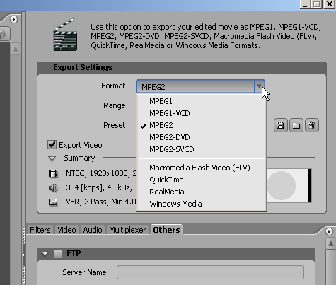

Thank you all for the replys - I have no edited all the commercials out of the video. Can I render these from Premiere to MPG2 so it will be ready for DVD? Or do I need other software for that? I am looking around the Export Settings and I don't see anything for MPG2.
I do see a "Range" under Export Settings. It says "Entire Sequence" and "Work Area". Could this be the reason I exported it and it still had commercials? Do I need to change this setting?

I did spent $50 buying Premiere 2.0 Classroom in a book, there is a section that tells how to use the Export Settings and it has a section for RealMedia, Windows Media Macromedia and MPEG Encoding, the problem is, my Adobe software doesn't have MPEG coding under this list. Could I be looking at the wrong spot?Originally Posted by pijetro
Yup, wrong spot..Could I be looking at the wrong spot?
Go to Export>scroll to bottom, and there should be an option for Mainconcept exporting.

Under File - Export - Adobe Media Encoder all I have under "Format:" is Macromedia Flash Video (FLV), Quicktime Real Media and Windows Media.Originally Posted by edDV
Should I have more under "Format:"? If so why isn't it there? Is it an add-on? -

In Premiere Pro 2.0:
Go to File > Export > Adobe Media Encoder. Then in the Dropdown list, chosoe MPEG2.
I stand up next a mountain and chop it down with the ledge of my hand........ I'm a Voodoo child.... Jimi Hendrix, -
Originally Posted by dipstick
That is where I have been going. I don't have anything above the line between MPEG and Macromedia. Should I try to reinstall? -
I have reinstalled Adobe Premiere and now all the MPEG options are showing up in the Export Settings, thanks all who helped!
