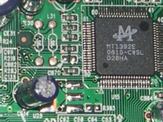

Non-HD related, but has anyone tried to take a look to see what chipset is in the 5960?
The 3040/5140 have similar menu screens, and are Mediateks.
However, from the screenshots ytsejam sent over the other day, the 5960's menu screens and firmware page look a bit different.
In other photos he sent over, from the internals shots, I was unable to make out any writing on the chipset under the heatsink. If the heatsink is pasted on there as firmly as it is in my 5140, finding out what chipset is actually in there may be a bit tricky...
The 5900 line was a Zoran 7xx series, IIRC, so I'm wondering if there's possibly a Zoran 7xx or 8xx actually under the hood of the HDMI/upscaling 5960 model....
EDIT: Of course, I COULD take a closer look at one of the pictures ytsejam sent over and see a small Mediatek 1392E sitting next to the 5960's main chip, but that would be too easy 8)

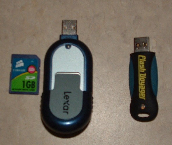

I have a Lexar card reader loaded with 1GB of SD memory and formatted as fat or fat32 plays files fine. Including DIVX. Now on the other hand my Corsair Flash Voyager 1GB thumb drive does not work. It says device not supported. What is up with that????Originally Posted by horo
Here is a pic of both devices..
I would be interested to know what thumbdrives you guys are using that DO work.
I wish someone could figure out what allows one flash drive work and another to not!
Have you tried plugging the flash drive in with the 5960 off, then powering up? -
I have tried everything I could think of. My Corsair thumber is only 3 months old and works great everywhere else. Guess I have to face the fact it will not work. For whatever reason. I have tried to contact Philips. Will keep trying. Maybe a future firmware upgrade could address it.Originally Posted by ytsejam

As to my thumbdrive, I formatted in all flavors and it always said Device Not Supported. So something about my Corsair it does not like. If anyone else has the drive and 5960, please let me know if it works for you..
I think I am going to goto Circuit City and plug it into one of the display models and see what it does on another unit.. -
