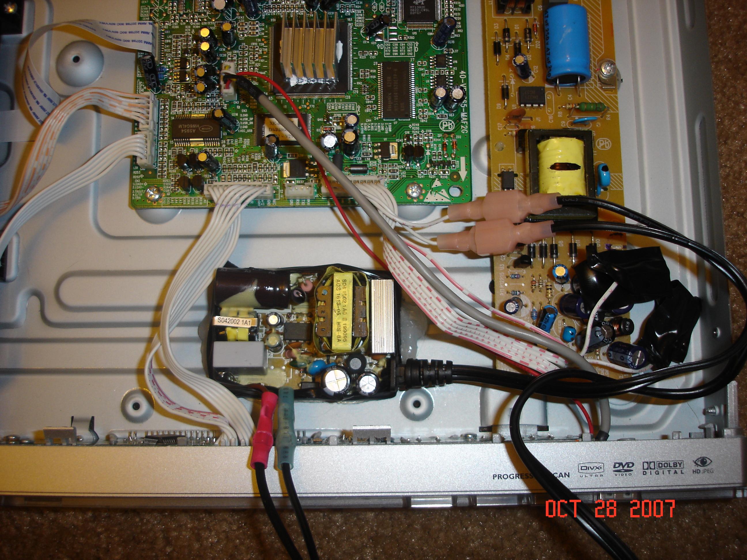

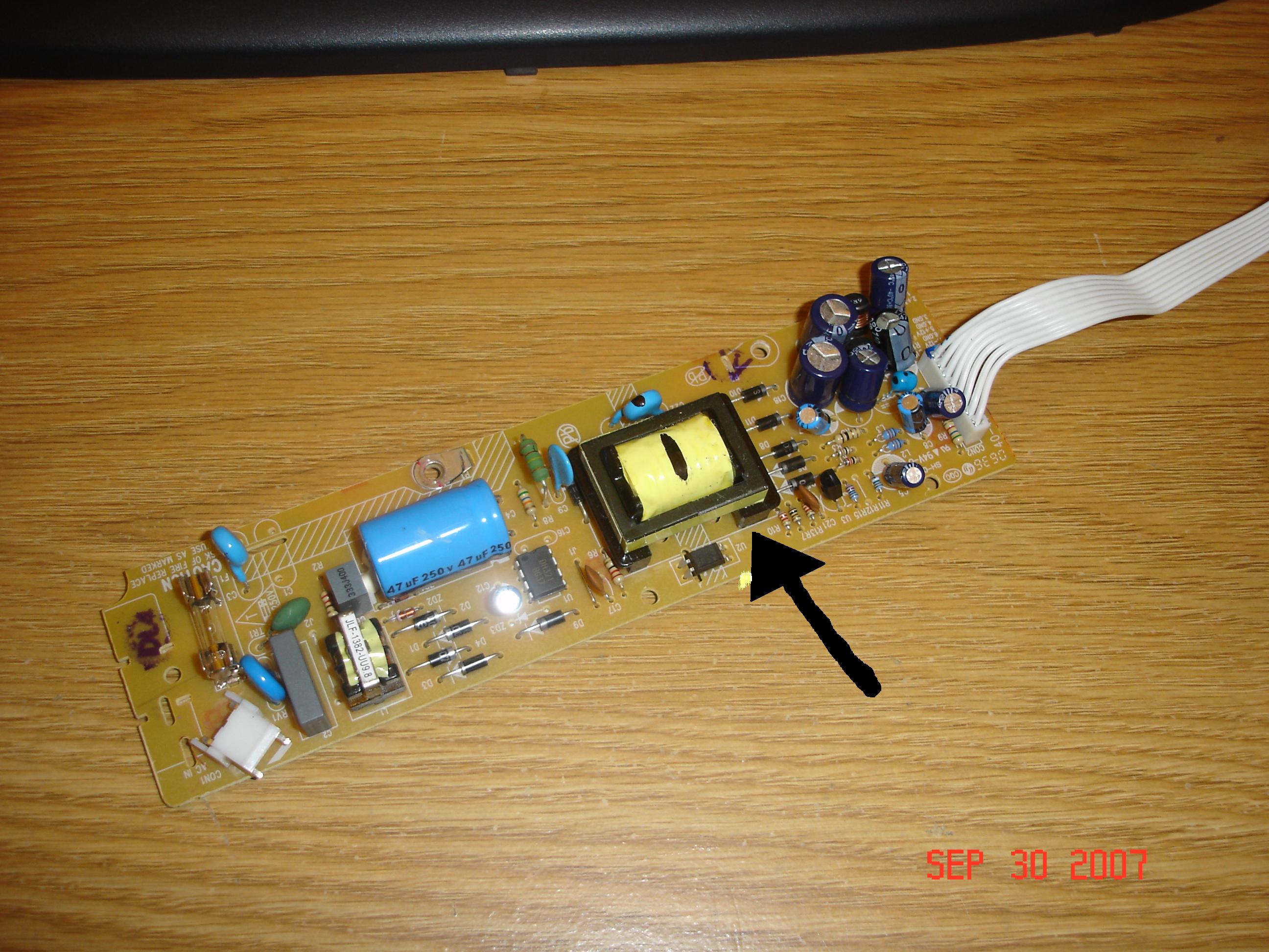

    I did it. I located the 5VDC supply and ground, cut them and taped them back, and Installed my own 5VDC Power Supply rated at 2.5 Amps. I grabbed a Power Adapter off of Ebay for $5 and broke the plastic casing. Put some friction tape on the bottom, wrapped it in electrical tape, and siliconed it to the bottom of the casing. It took 1 hour, $5, and some tape and silicone. Now I have a DVP5960 that can play any hard drive or flash drive that comes my way. And the best part is that I don't have any ugly extra wires to deal with. If any one needs any assistance, let me know. I also have pics if any one is curious. I am now going to try to do the same thing to my HTS6500 in my bedroom. Even though I already opened it to find there are 4 different 5VDC supplies going to different places. More complicated, but should be doable. I'll post later in about a week to see if anyone is still interested.

    Since I have received numerous PM's about my work, Here is a list of how to do it plus pictures.
    First, what you need are the following:
    1. 6 Butt Splices (Or another way to connect wires)
    2. Electrical tape
    3. Friction Tape (Or any thick Rubber)
    4. Silicone
    5. Normal electrical tools (VDC Meter, cutter, Stripper, Splicer)
    6. 5vdc 2.5A power adapter (Ebay for $6) Ask me who I bought it from.
    I can't guarantee that all 5960 are the same, so I don't take any responsibility if you somehow damage your unit. If you somehow would feel safer, I can do it for you for a price. Just let me know.
    First, take off the 5 screws on the back, and the two screws off of the sides.
    Next, remove the cover by pulling the back up and sliding the cover back.
    Now you need to splice into the power wires coming into the unit. (Please make sure power is unplugged)

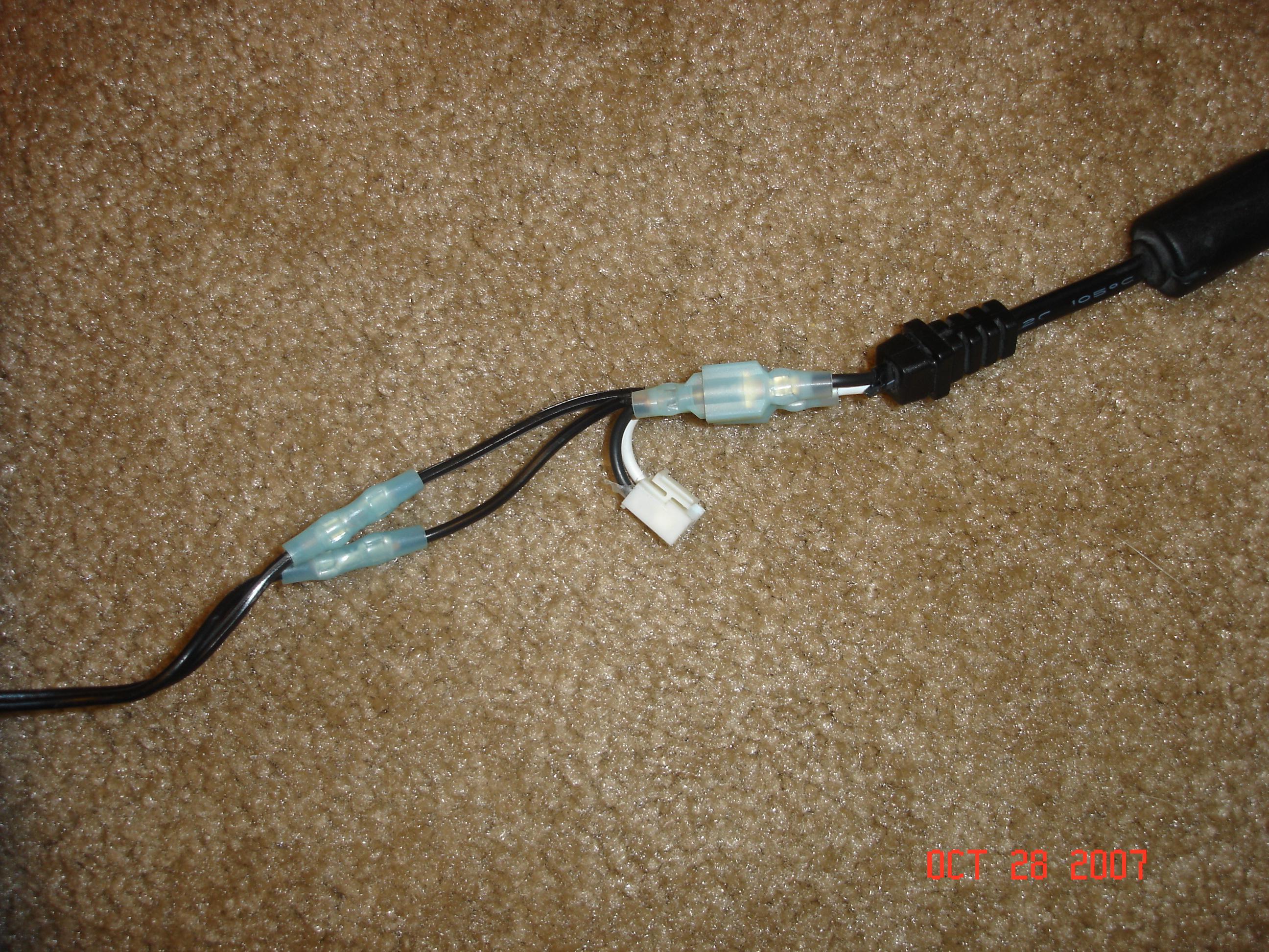

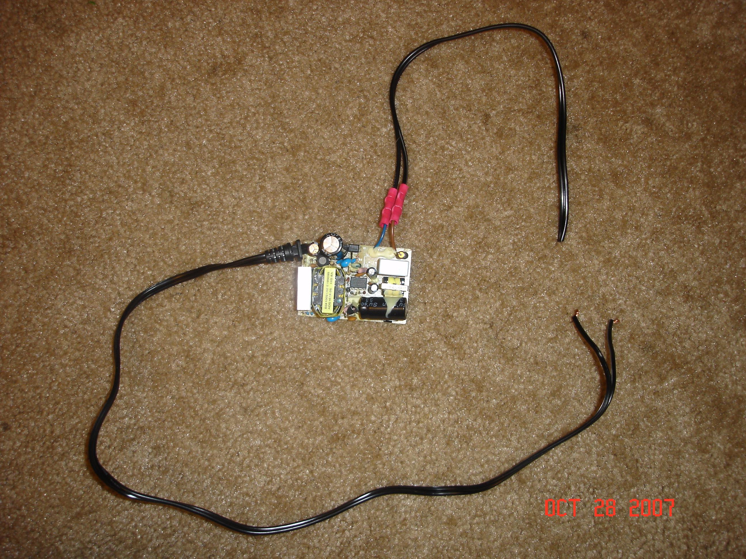

    Strip back as much jacket as possible on the power wires. Cut the wires a couple of inches away from the connector , strip and splice you're new wires (I used the wire from the Adapter, I just cut out a section) into the old wires. Break the casing on the power adapter and splice you're power wires into the adapter (blue and brown wires, my unit didn't matter which was power(same size terminals)).

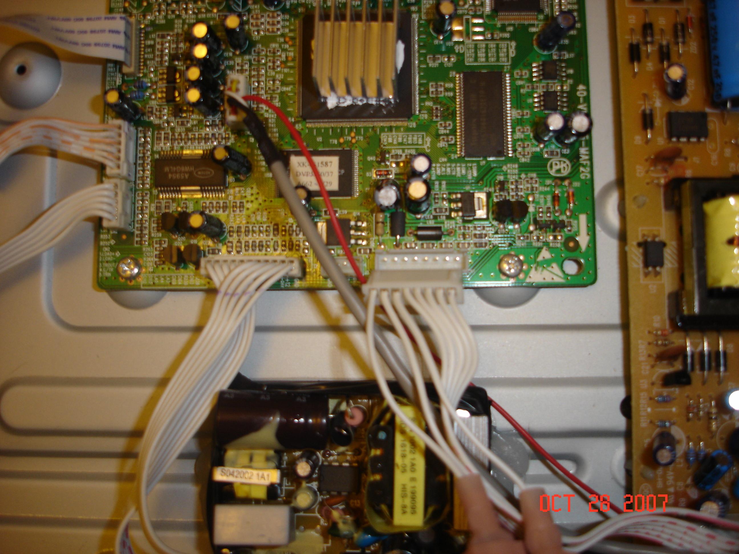

    It is very important that you separate your newly cut secondary wires coming from the adapter. Now strip them back. Plug in your 5960 cable now into the power outlet (don't plug it into you're 5960 unit) and test which wire is going to be the +5vdc and which one is common (ground).
    Once you know which one is ground, connect it to pin 3 of the connector on the power supply cable going toward the Main Board. To do this, separate wire 1 and 2 and 3 from the rest of the wires. Now cut wire 1 and 3 and strip them back. Tape off the incoming side from wire 1 and 3 from the power supply board (right board). Since you know which wire is +5VDC, connect that wire to pin 1 on the connector. And Now you know the ground wire, so connect the gound wire to pin 3.
    Almost done, put some friction tape on the bottom of the PCB of the power adapter and wrap it all in electrical tape so it won't fall off. Silicone it to the bottom and let dry so it won't move around if the unit gets moved. Put the cover back on and screw it in.
    Now I have done this write up pretty quick as I don't ever have much time. I am sorry if I left out some steps or if I went over your heads. Anyway I did this because I have 2 children and 1 on the way. I don't need them reaching my cables, which would happen if just bought a powered hub. Having said that, if I were to do it again and I didn't have kids, I would probably just buy a powered hub just because I wouldn't want to risk destroying my unit. I only say that because the usb on the 5960 was only meant for 500ma and I now allow it to pull as much as 2.5 Amps that's over 4 times as much max. My portable is only 1 amp so I am not really concerned about hurting my unit, but if you have a high powered 3.5" 10,000 rpm hard drive, I can't guarantee how long it will last. Any way here are the pictures and if you have any questions, send them to me. I'll try to get to them. Thanx. Actually, I need to change the files size and then I will send them. Thanx.
