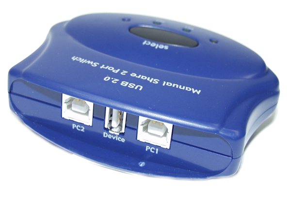

Anyway, I've got a variation of the above question - QUESTION #1:
For those USB drives that have two USB inputs, has anyone tried connecting one input to the 5960 and the other input to their computer or USB hub? Basically I'm asking if it's possible to access a drive remotely from your computer, while STILL having it plugging into the DVD player?
My situation is - my computer's only about 15 feet away from my DVD player. It seems silly for me to have to constantly shuttle the drive back & forth, it'd make much more sense to have it permanently hooked up to both the DVD player and the computer. (I don't need to access the drive SIMULTANEOUSLY - basically copy a couple movies to the drive, then walk over & power up the DVD, and it instantly recognizes the new files on the drive.) Has anyone tried this?

 Barring that a USB switching HUB like this one http://www.usbgear.com/US-67.html might work.Mediocrity is the new Gold Standard.

	Hi for your first question, I can say that I,ve successfully done it. You can purchase a 2 port USB switch at The Source (Can.) or Radio-Shack in the US (see attached image)...for about 30$. You can Google all these words (2-Port USB 2.0 Manual Switch)
 There are two Type B connections (one that is plugged to the PC and the other that is plugged to the External HD) and the connection in the middle is a type A (unless it's the other way around...don't remember my setup).
 Anyway, on the touch of a button, you can select where the External HD can be seen (DVD or PC). If the DVD is not powered, you can't switch (the light that shows DVD connection won't lit).
 The beauty of this is that you can add/delete files from ExtHD without unplugging before playback on DVP5960 !
 ...the only thing I don't like is the front location of the USB port on the DVD...
