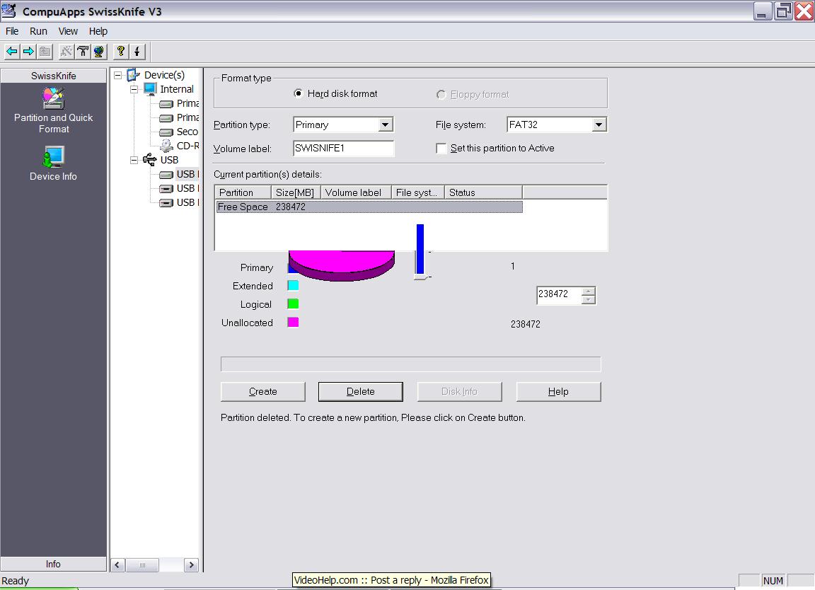

I've had the 5960 for a few months now and have never been able to get an external hd to work on it. I stumbled across this forum yesterday and read practically every post hoping i could get this thing to work. I've spent the last day clearing up 250 gigs so that i could reformat the hard drive correctly. I followed all the rules, i'm using swissknife, set it to fat32, made sure it was primary, made sure to plug it into an outlet and power it up before plugging it into the dvd player but i can't get it to work. Is there something i'm missing?
Here are what the settings look like just before i format.
Anyone using a 60gb Maxtor "one touch" mini III? I've read this entire forum and still can't get my drive to work with the 5960. I've converted it over to fat32 using swissknife. The drive did not come with an external power adapter, but it does have a dual usb connection where the 2nd connection is used for power only (if needed). I have a dvr that has a usb port and I plug the secondary usb for the maxtor into this just so I can have the extra power. After converting over to fat32 and using the additional power the 5960 recognizes the drive but doesn't show any content. It also makes a strange clicking or almost beeping noise. I'm not sure if my ears aren't that good but I can't tell if the noise is comming from the 5960 or the drive. The way I have the usb connected to both the dvr and the 5960 I can't move the drive far enough away to distinguish the sound source. The noise doesn't go away until I either power the 5960 down (drive still powered up through dvr) or totally disconnect the drive.
If any has any tips or suggestions I'd surely appreciate it.

@esc24
Everything in your screen shot is correct: Primary > File Type Fat32 > Label SWISNIFE1 (Their default).
All you have to do is click on Create.
Pie changes from Pink (Unallocated) to Blue (Primary).
NOTE: At this point it does NOT show up on your computer with the new label and Fat32 format.
Notice the note at bottom of screen “Please exit this application…newly formatted drives will appear shortly.”
Exit the prog, and click the “Safely Remove Hardware” icon in the taskbar for that HDD.
Disconnect the USB, wait a minute or two, then reconnect the USB HDD.
At this point, your PC should recognize it as Fat32.
I would rename it ie; DVP5960A or whatever, add some videos and it should work with your player. -
trac, thanks for responding, but i already tried all of that. From what i can see there's no reason this shouldn't be working. I'm guessing it's just a problem with the hard drive, because i don't see what else it could be.
