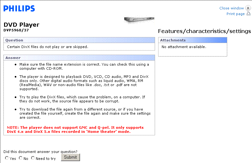

    http://www.p4c.philips.com/cgi-bin/dcbint/faqlist?ctn=DVP5140/37&dct=FAQ&slg=AEN&scy=US#
    Question
    Certain DivX files do not play or are skipped.
    NOTE: The player does not support GMC and Q-pel. It only supports DivX 4.x and DivX 5.x files recorded in 'Home theater' mode.
    Says the same thing for the 5960

    I checked the specs on the 5960 and (5900 advertised at BEst Buy). The 5900 is not listed as DIVX6 Ultra certified. The 5960 manual says it is and can handle Qpel and GMC.
    However under the FAQ for the model under the question does it support divx6 the answer is that all their divx players support simple profile blah blah blah... they don't answer the question.
    A few questions down it asks... Why won't some divx play and the answer is ...
    Here in the faq it says it does not support Qpel etc... strange???
    Sure needs an answer before purchase or it's not the big brother of the 5140
