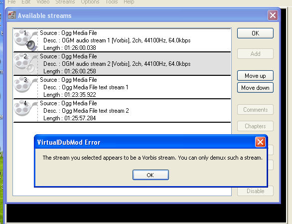

  3. OK, i'm no longer getting the fatal error causing VDM to shut down. But now when i try to use the Save Wav feature on the English audio channel i'm getting the following error message.

  4. sorry i didn't complete the message above. When i click on Demux it will only let me save the file as an .OGG file.

  5. I'm a MEGA Super Moderator Baldrick's Avatar
    demux to ogg and then use a ogg to wav converter like dBpowerAMP
  6. OggDropXPd is a dead easy-to-use Ogg --> WAV converter - drag and drop onto the tiny window and it does the rest. It is also freeware, and does not need to be installed (standalone application).

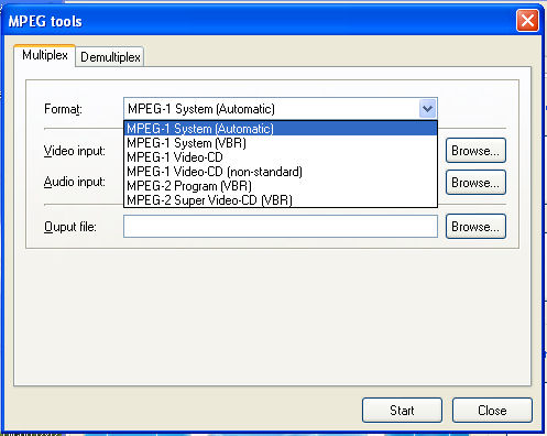

  14. Is the 23.976->29.97 pulldown an option in TMPGEnc Xpress or is there a better tool out there to get this done? And if it is an option on TXpress do you know where i do this? On the opening screen there is a MPEG Tools button below is a screenshot of that. If this is where i can convert it, which option do I chose in the menu here? This is getting very frustrating and I appreciate all the help everyone has been giving me...

  15. Is the 23.976->29.97 pulldown an option in TMPGEnc Xpress or is there a better tool out there to get this done?
    I don't know TMPGEnc Xpress, but TMPGEnc has it. Personally I prefer to apply pulldown with DGPulldown after encoding .
    In TMPGEnc it is an encoding option - frame rate of the output. It is called "3:2 pulldown during playback"
    As I said, it is an encoding option, not multiplexing option. Multiplexing is just combining video and audio in a way to meet some requirements, as listed in the menu you are showing.
    You can check the original (avi) and the Xpress output (mpg) for the number of frames. Load them in VDubMod and look file->file information. If the frame count is the same then pulldown was applied by Xpress (and the chopiness is due to something else). If mpg has more frames than avi then Xpress has introduced duplicates - so it is choppy at playback.
