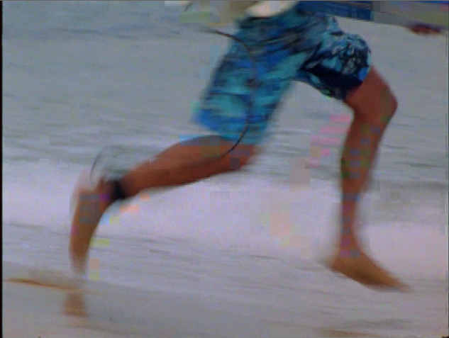

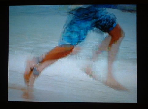

    Jan 2006
    Not sure if this will work, or whether it will make sense. It obviously won't flicker in this image, but on the TV, whether it's my HDTV or my NTSC tube, the legs are definitely strobing between the two interlaced film frames, at the same apparent 59.94 rate.

    What is the source of this video? is it a film or normal interlaced video?

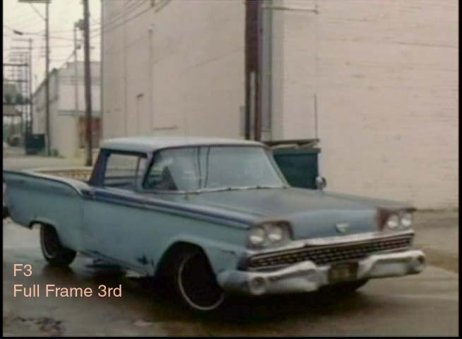

    The first frame shows the result of "blend" deinterlace in which two fields offset in time by 1/29.97 sec are averaged. When there is motion going on, you will get this double vision effect.
    You get something similar for telecined film sources on the frames that mix fields from differnt time samples as in this example.
    Full film frame @29.97fps
    Mixed Film frame @29.97fps Note image is doubled, but each field is clean.
    Ref: http://www.dvdfile.com/news/special_report/production_a_z/3_2_pulldown.htm
    Your image looks more like blend deinterlace (averaged).

    I assume you are in a stop frame of you wouldn't notice this. Your NTSC TV is showing the two fields at once @ 59.94 fields/s rate. The HDTV is doing a "line double" (see wiki ref above) and doing the same thing at 59.94 frames/s rate.
  16. And does it flicker when you output 480p from the player and then pause the TV? I never see any flickering at all when pausing my Samsung DLP, but I send 720p from my DVD player.
    Bobbing is a method of deinterlacing where you take a field and interpolate it into a full frame. There are good bobbers and bad bobbers. A straight interpolation loses half the resolution and causes jaggies/aliasing/shimmering. A good motion adaptive deinterlacer, such as that provided by the faroudja chipset, will leave static portions of the frame at full resolution by weaving the static portions of the fields together, interpolate the motion areas, but also smooth them to remove the aliasing, so it looks pretty darn natural. In the AviSynth world, motion adaptive deinterlacers are considered to be bobbers, and are called smart bobbers. They are considered as a completely different kind of deinterlacer in the video world, I think. I have no idea what your Sony does, but it's probably some kind of motion adaptive deinterlacing.
