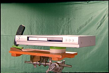

Like this?
You need the green in the shot to form the edge.
How to float a DVD player.
Or a puppet

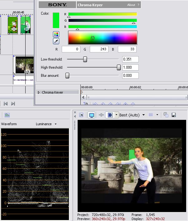

Here is how it works. Your set must include unique colors (in UV space) that can be used to separate the background from the foreground. The green area makes a green blob in color space that can be defined as background. Everything else is foreground.
Here the Vegas Chroma Keyer is adjusted for smooth edges. Next step would be foreground color correction to better match the background lighting. It's important to match light direction (shadows) as well to get this realistic. Gcloud did an excellent job matching lighting.
