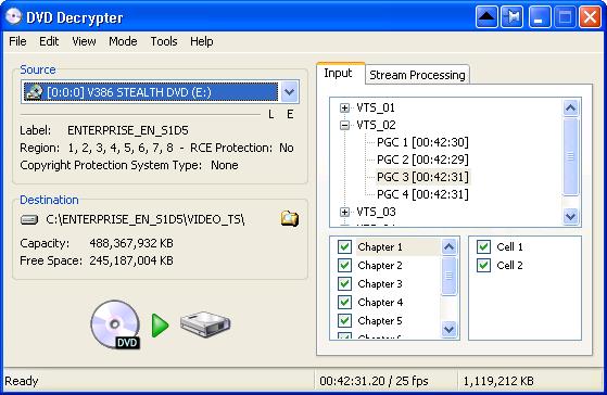

I am having trouble during the rip process. I am ripping Star Trek Enterprise. I have used the "P" option as the DVD has multiple PGC's in one VTS. The problem is that the same episode is copied into each "chapter" and the vob's are all the same. I tried to find a solution here on the board but I did not see anyone who has had the same problem. I can copy using DVD Decrypter by only selecting one PGC at a time. A bit slow and tedious so help would be appreciated. Thank you.
I don't understand. That's how you do it. The alternative is to encode the entire thing at one go and split them up afterwards (which doesn't always produce accurate splits).I can copy using DVD Decrypter by only selecting one PGC at a time.
If you prefer putting the entire DVD onto the hard drive using DVD Decrypter in File Mode, then you can split them up afterwards using PGCDemux to separate out the the individual VOB episodes. Either way, though, they have to be split up.
I couldn't figure out what the P Option is, but I didn't read much of the guide, either. I guess its whole purpose is to automate the episode decryption, but if you're not having any luck then I don't see any other option for you but to decrypt them all separately. Maybe Cheekie_Moonkie will show up and offer advice. -

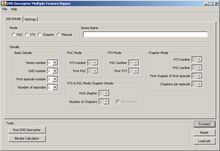

New Version of DDMFRip (2.00 (beta 1))
See the original post in this thread for more information.

Hmm... not sure what the issue is there. Can you tell us what you entered at each of the prompts (in DDMFRip)?Originally Posted by manono
Alternatively, you could try using the new beta of DDMFRip 2.00 (although I can't promise it doesn't have any bugs in it as I've not had much time to test it properly).Cheekie_Moonkie

I still use the old ddmfrip, which was great by the way and does exactly what I need. Why did you switch from DVD Decrypter to ddtool? Just wondering the reasoning behind it.
Hi Cheekie_Moonkie,Originally Posted by big69buck
I'd like to re-iterate my request for the original version, after seeing that I am not the only one posting and asking for the original version. There is clearly a need out there, and it appears that these requests are going unanswered. Please don't ignore your fans any longer!
Thanks,
bb. -
I really like your tool but with the latest version I noticed that I have in every feature folder the vob file that I wanted and a m2v file and a ac3 file, so the demuxed vob. It would be great if you could decide if you only wanted a vob or the demuxed files or both as I only want the vob and have to manually delete the other files as now it uses double the space.
Hi,
I need some help i want the latest version of DDMFRRip. I am currently using v1.05 I can't seem to find any newer versions or the 2.01 version. Can someone please tell me where I can get it from. -
i started out using the old ddmfrip which is really cool then upgraded to the DDTool Version 2.21 - (4th Jun 2009) which was far easier to use.
however when backing up my TV series DVDs of four or five episodes it will demux the vob fine but when remuxing to a single vob it will just hang there and not move on to the next vob until i go to the windows task manager and end the mplex process.it does not happen on every remux but on at least two vobs every process.
it is rare that i can back up a DVD withought this happening. are there any suggestions as to how i can resolve this.
it sure takes the fun out of the automation.
i am using version: DDTool Version 2.21 - (4th Jun 2009)
