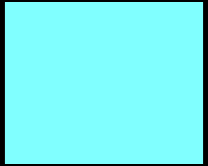

AutoGK will maintain the aspect ratio, following the information it receives from DGIndex (which is one of the applications that comes bundled with, and is used by, AutoGK). If DGIndex, for some reason, detects an incorrect aspect ratio it is possible to override it using the "Aspect ratio" setting within the 'Hidden Options' (Press Ctrl & F9 in AutoGK to access). So, if the source is mis-detected as 4:3 or 16:9 then you have a choice of manually setting the correct aspect ratio.
AutoGK also auto-crops the black space that you sometimes find in the margin of DVD video, but it still maintains the aspect ratio!
So, using this 4:3 example and using the same settings as in this guide:
This 720x576 .VOB:
...would become this 640x480 .AVI:
It may appear to you, in this example, that AutoGK has cropped more from the top and the bottom than the left and the right, but this is correct as there was a lot of black on the left and right in this .VOB, so AutoGK has had to crop a similar amount from the top and bottom to maintain the aspect ratio, else the video have would become "squashed" (for want of a better term).
It is possible to tune the auto-crop feature, by the way, from within the hidden options (which I mentioned just now), but personally I find the defaults work perfectly. -
