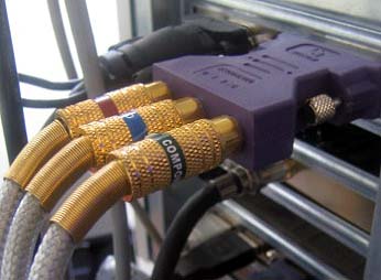

The ATI analog component HDTV adapter works with 8500 or 9550up cards (with Video Immersion II). Different versions plug into the DVI-I or VGA connector. Some cards use cable adapters. When the adapter is in place, HDTV modes show up in the Display Properties Advanced, Displays tab. This works in 1080i, 720p, 480p or 480i over the wideband Y, Pb, Pr connection.
NVidia's that I've seen use a breakout adapter like this.

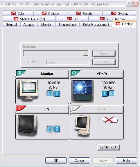

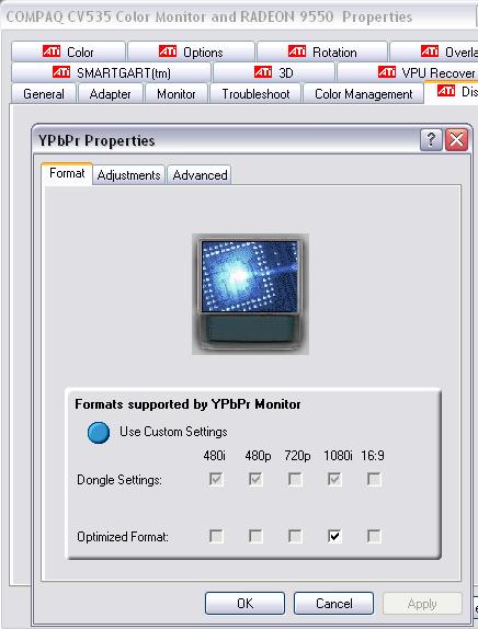

Here are the resolution setting windows that appear when the analog component HDTV adapter is used. The FPD (flat panel display) settings would be for progressive displays. The only progressive setting your TV can see is 480p. That is unless 720p is supported.

In my multimedia computer I have a Sapphire ATI 9550 chipset video card that outputs through a ATI to Component adapter and it works well with my video projector. I use the projector in progressive mode.
A link to the ATI adapter: http://shop.ati.com/product.asp?sku=2537967 The adapter will also work with some Nvidia video cards. The downside is that there are a lot of settings to adjust to optimize the output, make a note of them when you get the right combo for future reference.
