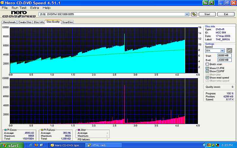

Hi! After having some prob. w/ my dvd player reading burned discs, (playback would freeze, & then resume) I decided to use the Nero CD Test pgm. Results of one disc are posted below; However, I do not clearly understand the test results! I read/reread the help files in Nero, & they do not seem to correspond with the program...
General Information
Drive: DVDRW IDE1008
Firmware: 0055
Disc: DVD+R (MCC 004)
Selected speed: 8 X
PI errors
Maximum: 8659
Average: 4593.42
Total: 15015904
PI failures
Maximum: 8603
Average: 383.96
Total: 1255162
PO failures: n/a
Jitter: n/a
Scanning Statistics
Elapsed time: 9:36
Number of samples: 3269
Average scanning interval: 42.08 ECC
Glitches removed: 3
Any help is greatly appreciated for this newbie!!!
Thanks!!!

BTC drive is not the best scanner drive.
If I'm seeing correctly - it looks to be verbatim media. If so, that doesn't appear to be the problem. The BTC 1008 is only an 8X burner - just because it can burn at 8X doesn't imply the burn will be perfect: Even if it will complete the burn without crashing.
I would recommend burning at 4X with that particular burner, then scan with NeroCDspeed - see if that improves things.
If you're committed to burning at 8X, install a 16X drive, many excellent choices available for $40 to $45 shipped. (i.e. NEC, Pioneer, LiteOn, etc..) A 16X drive will do a clean burn on 4X media (i. e. Taiyo Yuden) at 8X - I've seen it.
As to the scans: I look at two things: #1 Quality Score - less than 90%, it goes in the reject pile, probably accounts for less than 5% of the discs that I burn - typically less than 3%.
#2 Spikes at the end (outside) of the disc - indicates potential problem with playback, usually results in a lower quality score.
Your scan indicated the burn went to the edge without a problem, but with overall poor burn quality - IMHO the disc was burned at too high a speed.
I normally burn at 1/2 the rated speed of the burner: I.E. Plextor PX712SA (8X) burns at 4X; NEC 3520A (16X) burns at 8X; Plextor 716UF (16X) burns at 8X. This usually results in many fewer bad burns. -

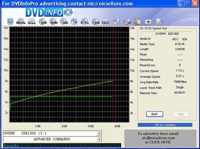

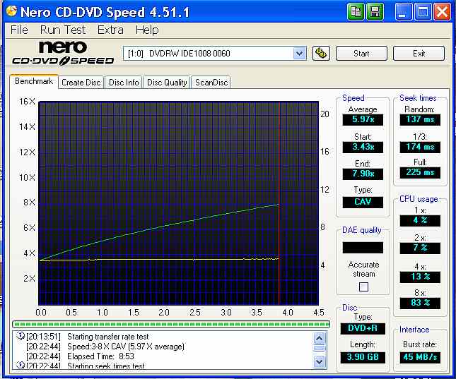

Verbatim (up to 16x) is the media. The burner automatically reverts to the burning speed that it wants to use, which with this meda was 2x. After I did the firmware update, it started burning in 4x... I did a transfer rate test & it provided me w/ the following results:
also did test w/ dvd infopro...
