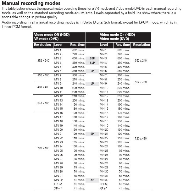

    I believe PCM sound is only available in the Fine mode (MN32) but you can check your manual. The following chart has been posted here before (for a dvr-531 - for nearly all Pioneer dvdr's)
    It shows PCM there at the bottom of the list (equivalent to the MN32 setting), but nowhere else. I've used MN32 and it does give PCM sound.
