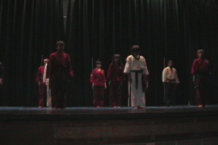

 Here is a example image mpeg snapshot.
 Another question: I captured the dv by using MF4 straight to mpeg2 for dvd editing. I usually use DVIO.exe but didn't see any adantage of having to re-encode again for DVD editing. Would DV straight be better for video correction?
 Thanks again.
	BTW, most would say "why even bother ?" after looking at that snapshot and I would agree but even after informing the parents how crap it is they want it bad...
 Its a no-win situation for me and if I thought I could get away with "the tape got chewed" I would try...
 Again, thanks for the help, I'm not expecting miracles just the best possible under the crappy situation.

	Raycaster,
 FWIW noting here..
 Right now, and from where I'm sitting, reviewing and analizing your
 posted image (though in jpeg -- not a good idea of posting these) I
 can see you image is showing its tipicle "grain-like" quality. And,
 I can see that it looks to be in the 16-235 color range. When you
 adjust this, you have (or should) do so in this same setup of 16-235.
 If you don't, you upset the balance of your images' black level, though
 you probably wouldn't notice it.. so its not that important to worry
 about.
 The other side to all this, is two-fold..
 1, Your camera's profile
 2, your scenary setup
 The bottom line here, is your sceneary setup. It's obviously a low-lit
 stage (try not to think of it as wrong) and you shot video of this.
 It is possible that you could have better prepared for this shoot, but
 (personally) I'm pretty sure you did not do this, and just took video
 of what was going on -- tipically so.. any normal person would have
 done the same thing in your shoes.
 The other factor, as I *briefly* note above, is your camera setup. It
 is obvious to me that you did not take any care or preporation in this
 area. Again, any normal person would have.. yada yada..
 Therefore, what you have is a low-lit stage on video by a camera that
 was not properly prepared for the scene, thus.. amature video footage.
 ( did I mention that I am not a pro ? )

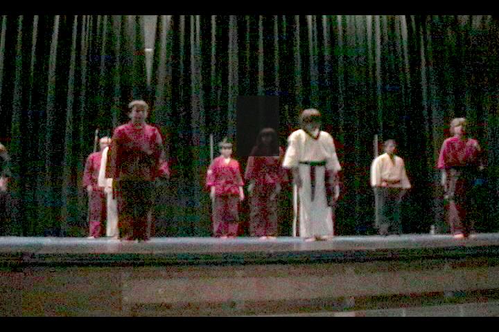

	Ok, I think I will have to end up using avisynth.
 Here's what I'm trying to do:
 That's an example of what I found from people using hdr agc. Is there a guide anywhere that teaches me how to use this scripting thing? Thanks!
 No other editting program was able to do that. premiere, videostudio, virtuadub, etc.
	Yes, a computer monitor produces a picture a little bit darker than does a TV set. However, what bluestar88 has to do with his source video goes way beyond the monitor/TV differences.
 bluestar88, I pretty much gave you the .avs script above, and that HDRAGC thread to which I linked before gives a bunch more scripts for you to play around with. Anyway, I was using ImageSource, because I only had the picture as a source. For the full video you'll be using MPEG2Source, something like maybe:
 LoadPlugin("C:\Path\To\AGC.dll")
 MPEG2Source("C:\Path\To\Video.d2v")
 ConvertToYV12()#if not in YV12 already
 ColorYUV(autogain=true)
 HDRAGC(coef_gain=1.5,coef_sat=3,reducer=1,Protect= 1)
 If your video is interlaced, you'll have to modify that script as shown in the first post in the HDRAGC thread over at Doom9
 Install AviSynth and the DGMPGDec package (it contains both DGIndex and the DGDecode.dll needed for your script) and stick the AGC.dll somewhere, like maybe the AviSynth Plugins folder. Open the MPG in DGIndex and go File->Save Project. That will give you the D2V file which you'll need. Create a .txt file, like maybe Video.txt, and then change the .txt extension to .avs. Inside of that now Video.avs file, put in that script above, adjusting for the paths. Try and open the script in VDub(Mod) and scroll around. Use what you learned in the HDRAGC thread to adjust the settings. You may not need the ColorYUV(autogain=true) line if you can get the output to your liking without it.
 For more info on AviSynth, go to www.avisynth.org. In addition, inside the DGMPGDec package are 3 help files, all of which, especially the QuickStart Guide, are very useful in getting you started using AviSynth.
	Hi-
 MPEG2Source is built into AviSynth. You don't need to download anything special. I already told you the things you download. I also suggested reading the QuickStart Guide included in the DGMPGDec package. Had you done that, you would have come across this:
 So, I might suggest making your first simple script of those 2 lines, and then opening it in VDub(Mod) to test it out. After you cross that threshold, you can then start adding in the other plugins and filters. And looking again carefully, I see I forgot to load the DGDecode.dll:What is This Index File and What Do I Do with It?
 DGIndex created an index file called *.d2v. It is read by DGDecode, which actually decodes the MPEG and delivers the video. The index file just contains information that tells DGDecode where each frame is located and some information about each frame.
 But you can't just execute DGDecode directly! It has to be done through Avisynth. We'll make a script file called myvob.avs using a text editor. Later in this document I'll show you how to configure DGIndex to make the script automatically, but for now, you need to know the old-fashioned way. So put this text into a new text file you make called 'myvob.avs':
 LoadPlugin("...\DGDecode.dll")
 MPEG2Source("myvob.d2v")
 Replace the path '...' in the first line with the path to the location where you placed DGDecode.dll.
 Finally, use VirtualDub to open the 'myvob.avs' script file just as if it was an AVI file. That's it! You have your video and can navigate randomly on the VirtualDub timeline. Does life get much sweeter than this?
 LoadPlugin("C:\Path\To\DGDecode.dll")
 My fault entirely. Sorry to waste your time and cause you frustration.
	Hi everyone... again.
 I was not able to get these results with HDR AGC =(
 Here are his settings: http://forum.doom9.org/showthread.php?p=648321#post648321
 I don't know why his vid came out so clear! I cannot do "ConvertToRGB32" like he did. Would that make the difference? I wonder how he was able to get those results using HDR AGC?
