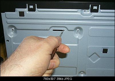

  9. Yesterday i put what was supposed to be a blank disk to record something, about 30-40 seconds into the disk a pop up comes on the screen and something may be worng with the disk and the unit will automatically power down and strat back up. This has happened before, the difference being the disk popped out. this time the recorder comes on by itself reads the disk that is in there and shuts down. this has been happening since last night and all day today and tonight until i unplugged th unit cuz i got tired of hearing the disk reading. ANY help would be appreciated this dvd recorder is less then a year old but i can't fix it and i really don't want to have to buy a new one.
    Nov 2007
    Minneapolis MN
    It would help if you would have said your model number but if it's a EZ model recorder stuck in a endless loop(with a DVD stuck in the drive) you may need to manually eject the disc to regain control.
    You'll want to unplug your machine, turn it over and look for a manual eject slot. It won't be marked but should be under the DVD drive. Generally you need to insert a smaller screwdriver to release the DVD. I believe all Panasonics have this manual eject slot but if you can't find it or can't get it to work then you may need to take the cover off your machine and remove the DVD from the top. If you go this route be particularly careful to remember how to re-assemble the drive.
    Generally after removing the DVD your machine will return to normal, it's up to you if you want to try reinserting the DVD. Personally I'd try another one first to make sure your machine is still working, then maybe put your suspect DVD back in and see what happens.

  13. I turned it over to look for the self eject button and didnt see it, i just got off the phone with panasonic and they say i need to send it them cuz the disk may have damaged the unit
    Nov 2007
    Minneapolis MN
    If under warranty you could do that(not sure who pays for shipping) but there should be a slot.
    I'm not near my EZ-28 at this moment but I'll try some searching and see if I can come up with a link to a photo showing the slot and instructions on how to get the disc out. I know I've seen such a post but a quick search came up with nothing.

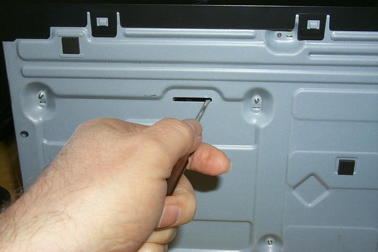

  15. Texan V Bot's Avatar
    Feb 2006
    Check this pic outClick image for larger version
ID:	2657 I too own a Panasuckic.
    It Started In Texas

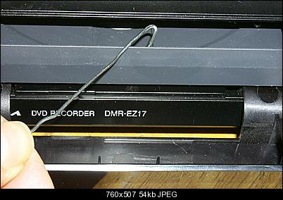

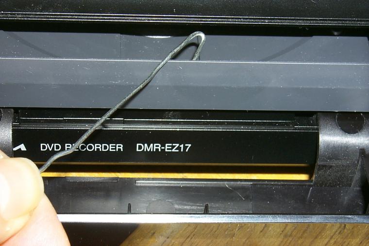

  16. Texan V Bot's Avatar
    Feb 2006
    Here's another
Name:	HOOK TRAY & AND SLIDE OUT.jpg
    It Started In Texas
    Nov 2007
    Minneapolis MN
    Thanks Vbot, you found the same source as I just did. Digado over at AVS has posted several nice photos, here a link again courtesy of Digado.
    http://www.avsforum.com/avs-vb/showthread.php?p=18656384#post18656384
