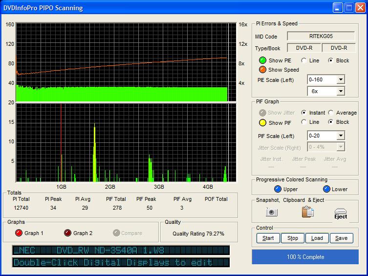

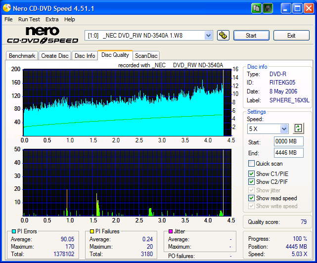

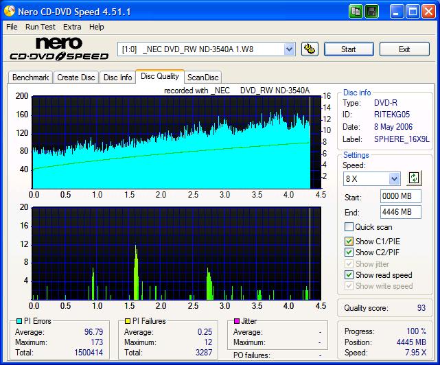

    Just did a quality test using Nero cd/dvd speed & dvdinfo. Any idea why the dvdinfo graph looks strange ?. The disc was burned at 4x.
  2. Originally Posted by bidefordboy
    That looks a little hokey to me. PIF graph is somewhat similar on both. The NEC 3540 is one of the few NEC drives capable of reliable scanning. I know nothing about DVDInfo Pro but I do know that the preferred scanning speed for accuracy with that drive type in CD-DVD Speed is 5x. That may very well be the case with the other product as well. Try that and see what you get.

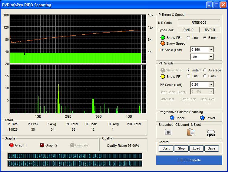

    Thanks for the reply.
    As suggested I tested the same disc again setting nero to 5x, & dvdinfo to 6x (as this was the nearest).
    The disc seems to have developed a nasty 'spike' since the last test. It's only been played once & visually the surface looks perfect. This has, of course, reduced the quality score.
    Still the unusual Pie graph in dvdinfo. Perhaps its a bug in the programme.
    This is why PIE/PIF tests have limited value. It's just not scientifically sound, so many variables can throw off results or just entirely give you a screen full of jibberish (as we have here).

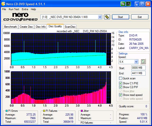

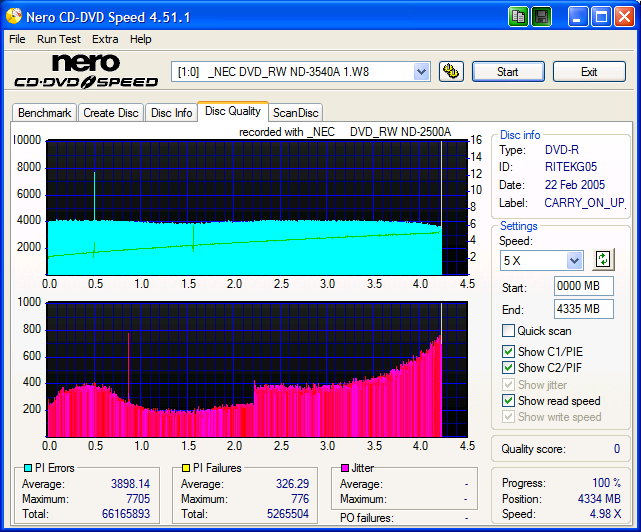

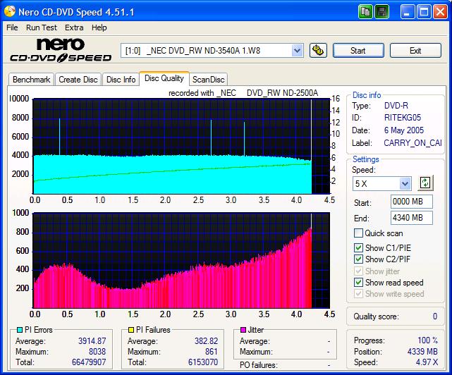

    lordsmurf. I appreciate that quality tests like these only give an idea of the quality of the disc.
    Have attached scans of some of my 'Carry On' series of discs that I backed up over 12mths ago. These were burned on a Nec 2500a. Have always used Ritek because I very rarely get a bad burn, & the discs play back ok on my three dvd players.
