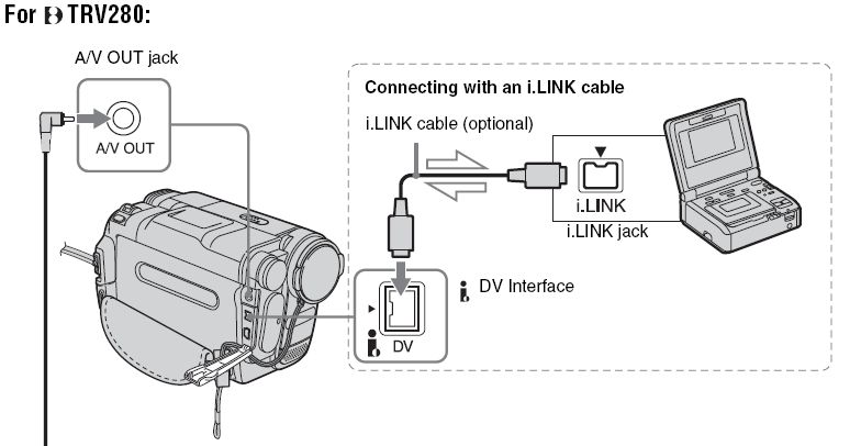

    From your manual P-60
    http://esupport.sony.com/US/perl/model-documents.pl?mdl=DCRTRV280&LOC=3

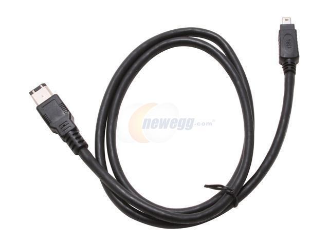

    Get this type cable
    http://www.newegg.com/Product/Product.asp?Item=N82E16815999001
    The camcorder end is 4 pin, the other end (computer) is usually 6 pin but may be 4 pin.

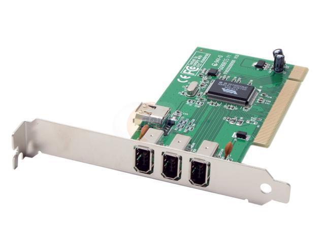

    http://www.newegg.com/Product/Product.asp?Item=N82E16812189108
    If your computer doesn't have a IEEE-1394 input get an adapter (PCI or PC card).
    http://www.newegg.com/Product/Product.asp?Item=N82E16815165002
    http://www.newegg.com/Product/Product.asp?Item=N82E16815124031

  18. edDV gave an example of an inexpensve firewire card you can add to your computer:
