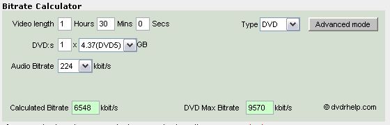

Use a bitrate calculator to figure out what bitrate you need and then set the MPEG bitrate manually.

In UVS go to the Video Capture Property Settings dialog. Press the Advanced button. Set the bitrate value to ~5300 to put 90 minutes on a single layer DVD.
For different lengths use a bitrate calculator to figure out the bitrate. For a rough guide use this equation:
480000 / minutes -

I'm getting the Mainconcept MPeg2 encoder demo to work fine from my DV transfers or from the Canopus ADVC-100 DV transcoder, but you do have to set the bitrate manually. If you set 6500Kb/s it will get 90 min. on a DVD.Originally Posted by smsmasters
If you want a differnet length, use the calculator and set the bitrate. The minimum bitrate that can be used is a function of the CPU power. 6500 Kb/s works most reliably if the CPU is >3GHz.
