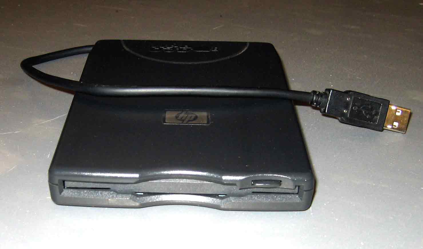

    I've got a USB powered floppy drive that came with my laptop. It boots up first just like an internal floppy and I've used it quite a few times when I need to load a file from a floppy. I don't install floppys any more in the computers I build, so it comes in handy at times.

    This one I have shows as A:. I just plugged it into a computer that has a A: drive and then it shows up as B:. It seems to work on all the MBs I've tried it on. It's powered by the USB port. I've wondered if there is a program out there to emulate Drive A: with a USB thumbdrive? Then I would just use one of those.
    The USB Floppy drive is a Mitsumi D353FUE. I got it from HP free with the laptop.
