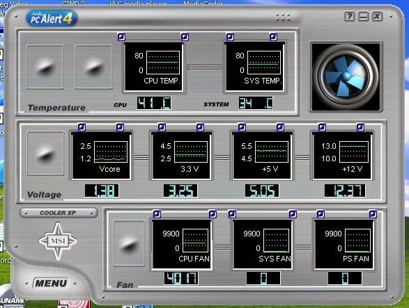

I just got off the phone with the technician, and he told me to download a program called "speedfan" and see what readings I get with that. By going into the bios, and disabling the smartfan, what happens when a person turns their computer on and it has that really high number that causes the alarm to go off. There seems to be a scale on the different windows, for the CPU Fan there is a 0 to 9900. It usually gets to 4200 or 4300 at the most, other than that red number after the computer starts 12053, and that is only after I have completely shut the computer down and shut off the power supply.
I think part of this has to do with room temperature. Sometimes in the winter time it gets down to 60 degrees F in this room, and then the CPU and System have to heat up, because the numbers will be low on them and in the red. I am going to look around in the BIOS, after checking my current temperature, and see if they match. I will try to disable smartfan and see what happens.
I am enclosing a screenshot from PcAlert 4 that I cropped to focus in on the PC Alert 4 Display. Maybe it will give you a better idea with what I am dealing with.
pc%20alert%204.jpg -
looking at that screenshot it looks ok ... u need to set the value for the alarm .... in the setting of pc alert you can set the speed at which the alarm sounds (from the screenshot i suggest 3800 rpm) if there is an alrm function built into the mobo you will need to set the value in bios too (or disable it and let pc alert handle the alarms) if fan speed drop below the value set an alarm will sound ... you should turn off smart fan though otherwise the fan speed may drop below the alarm limit ... you can also set an alarm for cpu temp in pc alert (and in bios if it supports cpu temp warnings) ... you should set this to around 70 dgrees c (depending on your cpu)
psx_pirate: The only thing I can set in the settings for PC Alert is how long the Alarm Sound lasts for. It doesn't allow anything else to be set, it just seems to monitor temperature and fan speeds, doesn't allow you to actually do anything else.
I went into the bios, and if anything the actual temperature is higher than what PC Alert is showing. The computer is more or less idil and the PCU temperature is 54C and the system temperature is 34C.
There was a setting called CPU Smart Fan Temp, which wanted me to enter a temperature in the Bios. I changed the alarm to go off a 70C and for the system to shutdown at 80C.
