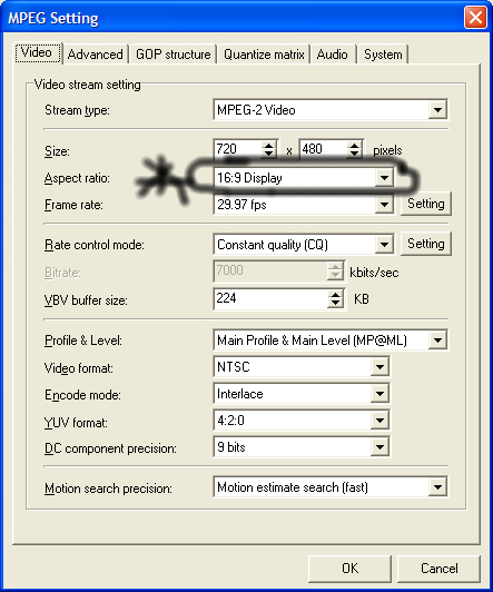

  1. I've got some videos that I'd like to burn to DVD, but the problem is that they're XVid and in a widescreen format and if I just use an authoring program, like Sonic DVDit!, Roxio DVD Builder, or Ulead DVD Movie Factory, it will squeeze the widescreen into 4:3 format and it will look squeezed on a 4:3 TV and on the computer.
    I figured I could just go in and add bars using TMPGEnc and adding borders to the top and bottom, but evey time I encode the video comes out choppy. I've tried encoding to .m2v, mpeg1 and mpeg2, but every one of them come out choppy.

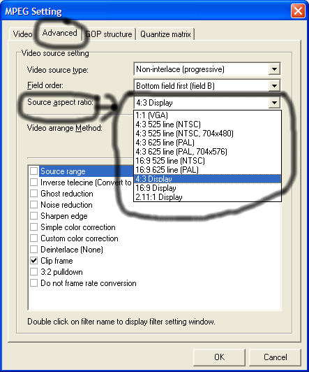

    If you're using tmpgenc and you want to preserve the 16x9 ratio on the output you must select 16x9 input for the video mode and 16x9 video mode for the output.
    Be sure to highlight 16x9
    For output select 16x9 as well:
