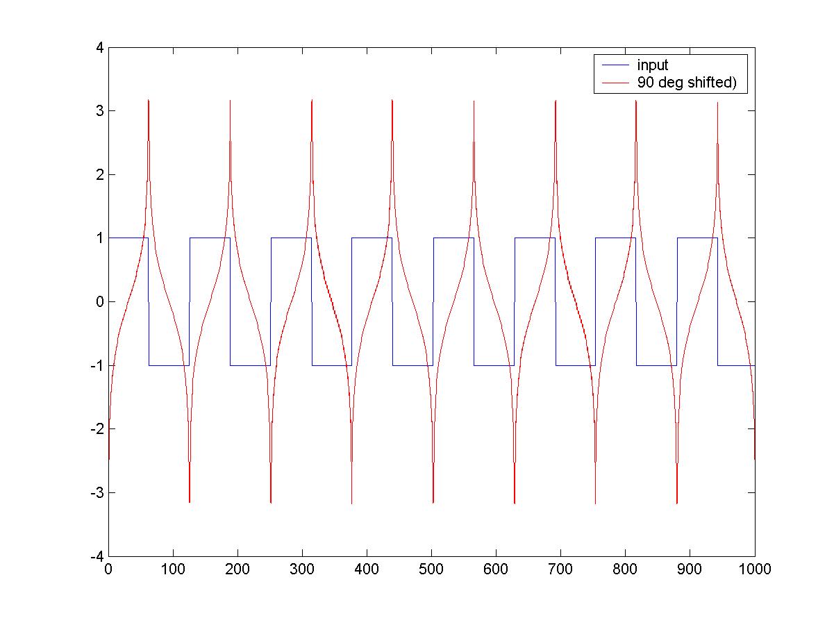

    BTW. Here is an example of 90 deg. phase shift of more complex waveforem (square).
    I hope this is helpful

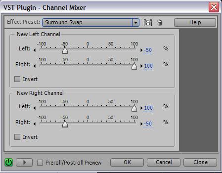

    Originally Posted by GavSalkeld
    Thanks, guys, although all those 0.285867 things mean nothing to me lol. Can anyone answer the other questions I posted?
    What is the other question?
    Please read my post carefully. I have explained what (for example) 0.2645 means.
    It means changing gain by 26.45%, and I think you can do it with any wave editor,
    including the one that u use.
    Actually, the VST channel mixer seems to be very much suitable for that.
    Can you mix 6 channel sources with it?
    If yes, please do the following
    CREATING DPLII LEFT CHANNEL (sliders settings)
    26.45% for input LEFT
    18.71% for input CENTER
    18.71% for LFE
    -22.91 for SURROUND LEFT
    -13.23 for SURROUND RIGHT
    CREATING DPLII RIGHT CHANNEL (sliders settings)
    26.45% for input RIGHT
    18.71% for LFE
    13.23% for SURROUND LEFT
    22.91% for SURROUND RIGHT
    So you can see that all 6 channels are utilized in order to create the new stereo source.
    If you cannot set gain in % so precisely, the rounded values are still fine (e.g. 26% instead of 26.45%, or -23% instead of -22.91%, etc, etc.)
    I hope this will work.
    Cheers, 3d

    So in theory, I can make matrixed 6.1 tracks using phase shift? Is it possible?
    What are surround panners, and all those others you list?
    The only thing IS, I dont know what thats really doing. Is that keeping the stereo elements of the music on the same channels, but reversing the (natural) surround encoded information contained within the audio? I also dont know what those numbers represent, I tried the Help file but it doesnt explain. I mean what does -50 mean on that scale, for instance?
    Thanks fellas.

    -50% means multiplying the signal by -0.5. This means reverting
    the signal (changing its sign), and changing amplitude by half (50%).
    So it is not a rocket science

    In general, all these operations, that are performed during DPLII downmixing allow to analyze the signal complex spectra (for left and right channel) and with some DSP operations 'reverse' the downmixing procedure. The decoder assumes that certain weights were used during downmixing, and therefore it is so important to follow the procedure that I've described (i.e. the exact gain manipulations are so important)
    The 'reversing' does not allow to retrieve the original perfectly,
    due to many ambiguities, but still allows for some basic 5.1 panorama reconstruction.
    Therefore DPLII should be viewed rather as some cheap alternative to a proper digital multichannel format.
    The decoding is pretty much complicated, and if you are not DSP expert, it will be difficult to understand it.
    Please do some tests with downmixed 5.1 signals on your HT amplifier, or with the use of our DirectShow filter to find out how it sounds, and how it differs from original 5.1 source.
  20. Originally Posted by 3dsnar
    Well setup picture you saw there that I posted was applied to a stereo form and it didnt sound like a simple channel mix. The audio sounded all... weird (for want of a better word!) whereby the audio sounded like it was "in my head". Why did it do that?
