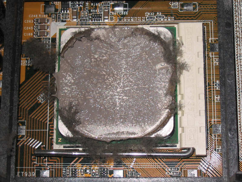

Agreed. My CPU recently needed this done (two days ago) and my temperatures dropped significantly. It was filthy, anyway:Originally Posted by zzyzx2
If you're sure your heatsink is good, try sanding the bottom down, working from coarse grade paper to fine. Don't go for a mirror-like shine, though, as some guides will tell you to. Some fine scratching helps heat to be conducted.
Make sure thermal compound is good, and that it is spread thinly, but not too thinly. Too much is as bad as too little.
Finally, ensure that the clip holding it on holds it securely.
