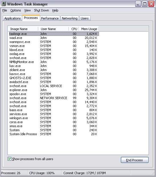

    Please help me with this problem.
    As soon as I connect to the Internet (Dial up) service "svchost.exe NETWORK SERVICE" goes to 99% CPU usage and nothing works. I have to end the task to get to normal, if I can call that normal. Is there any way I can eliminate that service somewhere? This problem only started after I did a clean install of Windows XP SP1.
    Any help will be appreciated.
    John

  8. joollyjohn jollyjohn's Avatar
    Mar 2005
    Sydney Australia
    G'day guys

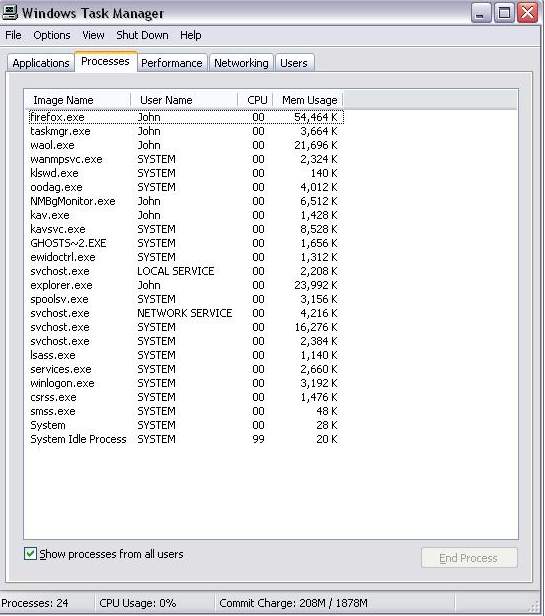

    Sorry I didn't answered earlier. I am overwhelmed to see so many responses.
    I'm sure it is or was a virus of some sort. I run Spybot and found 7 instances of Windows redirect (or something like that) and 1 Alixa. Ewido found 2 bad cookies. CWShredder found a number of infections. too. Kaspersky failed to find anything. I also removed a few entries in Hijackthis.
    Please find pics of before and after, of task manager.
    I'm going to try the tips given by you guys and see if I get rid of a couple of processes.
