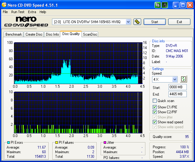

Playo 8X UME01 media code burns nicely at 8X with decently low PI\PO errors
in my NEC-3550A (stock 1.05F firmware). -
so getting back to the Staples disc. I tried the 16x on my Benq 1655 w/ BCGD and had better results w/ the DVD-R written at 12x compared to the DVD+R. I posted my disc scans at CDfreaks. btw, ppl w/ Lite-on drives were have a really difficult time w/ these disc, crazy jitter and PIE's.
so in sum, DVD-R>DVD+R, and BenQ>Lite-on for the Staples disc. btw, some ppl are claiming the 8x disc produce higher quality burns, but have you look at the tops of the discs? talk about fugly! -
This was the best I ever did with my Liteon but it took some experimenting. That's a 12x burn with SB-HT-OHT on.Originally Posted by EatMoreChickens
