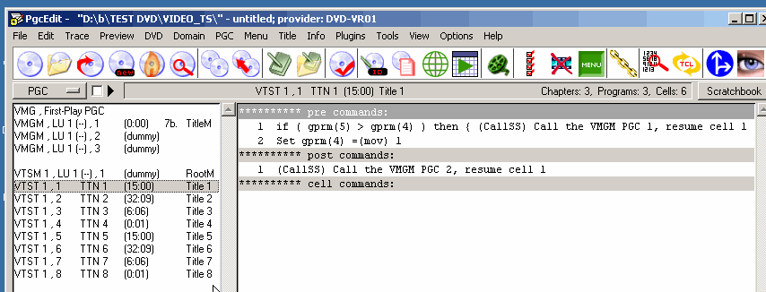

    A simple test burning three (3) titles to a DVD-RW disc showed this structure using PgcEdit
    (During loading in PgcEdit, the BOVs kept running through the VOB_01_x , as in circle (?)
    - I had to finally abort the BOV function.)
    8 titles are listed - the 3 titles are listed twice and 2 dummy titles (title 4+8).
    The only difference between Title 1 and Title 5 is in the pre-commands:
    Title 1: 2 Set gprm(4) = (mov) 1
    Title 5: 2 Set gprm(4) = (mov) 129
    (i.e. adding 128 to the value stored in register 4)
    (The 3 titles are small TV recordings burned on my Philips DVDR3450H recorder.)
    DVDShrink 3.2.0.15 (the latest version) is strictly applying to the DVD format standard and will therefor have problems parsing the DVD structure - at best showing only the last title (and list it twice - here in this test title 3). Title 1 is identical to Title 5, Title 2 is identical to Title 6,
    Title 3 is identical to Title 7 and Title 4 is identical to Title 8 - but the titles 5,6,7,8 are all empty.
    Is this the reason why DVDShrink fails ?
    Using FixVTS and/or using IfoEdits "VOB Extras / Create new IFOs" on the VTS_01_0.ifo appears to solve the problem, and it will do this in-place (changing the actual files without creating any backups). It worked on my above test DVD disc - The main menu was split into two parts and only moving the cursor below the button gave me access to an otherwise hidden button, which in turn gave me the possibility to move down one page and there I found the original menu.
    Title 2 was the "Main Movie", and title 1 and 3 was "Extras" - Th dummy title 4 was the first second of title 1 (maybe this is the title used to change the mode, i.e from 16:9<->4:3).
