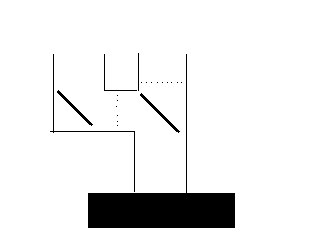

It uses 1/2-silvered mirror and 2 liquid crystal shutters, each of which opens/closes alternately with the other. They are timed/synched with the vertical interval pulled from the camera's video-out signal.
Here's a rough/quick example of the inner-workings:
(The dark bars are the front-silvered and 1/2-silvered mirrors, the dashes are the LC shutters)
The views enter from the top, going seperately into the L and R side. They are allowed to show alternately onto one or the other side of the 1/2-silvered mirror, which routes the remaining signal, now Field-Interleaved, on the camera lens and body proper.
This type of device works very well with mid-level DV cameras. Obviously, it won't fit onto small, cheap, consumer-level cams because of their small lens size, and pro cameras would do better to have 2 cameras twinned, maintaining tight calibration and synch.
