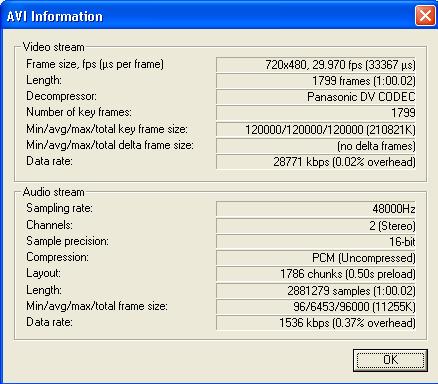

Here is the File Information from Virtualdub:

I don't see any obvious problem with the AVI information.
