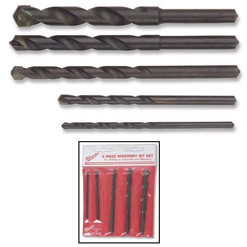

Oh, with everybody mentioning masonary bit. And nobody bother to show a picture of it. You may want to know what it look like..........
