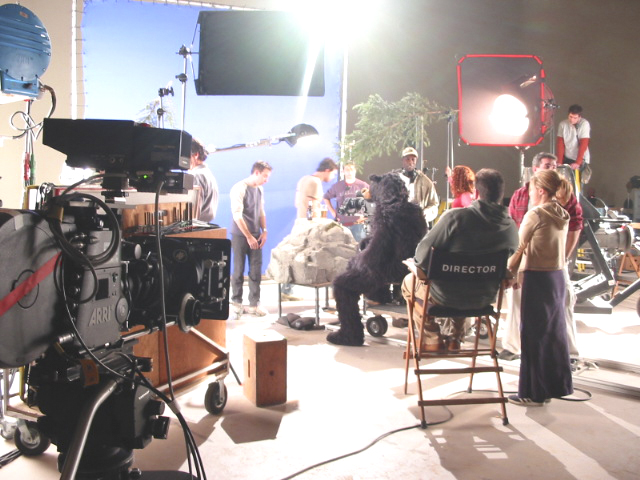

Image resolution is only one of many factors that make a "Holllywood" quality movie. A professional shoot has every detail planned and lighted. Even scenes in bright sunlight have massive lights to control contrast. The camera is a factor but maybe contributes 30% of the difference (e.g. Sony HDCAM SR vs say a VX2100). The rest is set control, lighing, camera support and control of scene motion.
It isn't fair to compare home camcorder shoots to Hollywood films. A closer comparison would be your 6:00 news field shoots or low budget cable magazines. There they are using camcorders in the $6,000-30,000 range and one key light or a key and a fill. If they are shooting available light, it will look alot like a home movie.
For standard DVD quality, the basic rule of compression is the higher the quality of the original acquisition, the better the compressed result will look. Professional film and TV show production are shot with MPeg compression in mind. Camera supports are rock solid. Pans and zooms are done with linear motion paths to ease the job of encoder motion estimation.
Almost nothing is hand held.
Typical set.

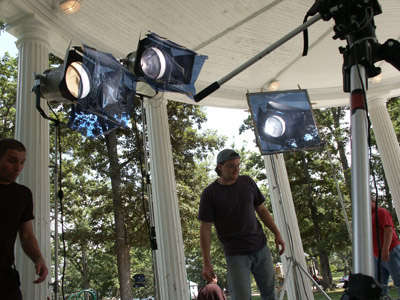

An example of a low budget independent "film" production done with skill, not throwing money at a camera. Note that they put more money into renting the lights than the $200/day Sony PD-150 SD camcorder.
