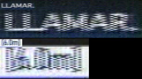

	OK, will make this as simple as possible. My next sample is moving text captured live from NTSC SD TV. Firstly I want to rule out that the captured source is a TC film format nor is this IVTC when reencoded to MPEG. Everything here is as ease except for the TFF and BFF setting. I can safely say this because the fields are clearly distinct in each frame during motion nor do I set the encoder to IVTC during encoding to MPEG. Also during playback I also make sure the deinterlace filter is OFF to show both fields as distinctly as possible.
 Here is the screenshot. The motion of the text is from left to right and both fields show different temporal positions here and the same for every captured frame
 This was encoded using TMPG Express and played back with different MPEG decoders and surprisingly both cannot agree how the fields should be rendered.

	If every frame has interlace comb artifacts then you don't have telecined film. Telecined film has a distinctive pattern of three progressive frames followed by two interlaced frames, repeated over and over (other patterns are possible). Note that the crawling text that has been overlaid can be fully interlaced while the rest of the picture is telecined film.Originally Posted by enbidia
 You should post un-resized crops. Resizing has blended the scanlines in your images. I recommend you use VirtualDubMod to save frames. It saves images 1:1. A 720x480 capture will produce a 720x480 image file. This will make it much easier to see what is going on. It's also easy to save out exactly the same frame for comparison.Originally Posted by enbidia
	Even though bicubic resampling may introduce some artifacts maybe some additional blur when pixels being enlarged are not exact multiple of its own both horizontally and vertically. What important here is the relative positions of the fields with each other could still be discernable or inferred whether it is up or down or left or right. For clarity here's the image again at its original size however JPEG compressed at maximum quality however cannot capture the same frame number because i'm not using a video editor and there is no reference to frame number. Be assured that no matter which part of the video the fields do not change. So no matter which frame number I captured it will still look exactly the same as below.Originally Posted by jagabo
 I don't know about VirtualMOD but I don't think its useful. Because we are comparing different MPEG playback codecs here.
	I'll grant you it does appear the two MPEG decoders are playing the files differently. I'm not sure what your point is though. All that really matters is that the MPEG be encoded as interlaced and that the field order be flagged correctly. Then when you play it back on an interlaced device the fields will appear in the correct temporal order.Originally Posted by enbidia

 Even your original size post has been resized. I can tell because the two fields are blended together at points. Here's a 4x nearest neighbor enlargement (each pixel is simply duplicated 4 times, with and height) of a portion of your image and a 4x enlargement of a quick capture I made of similar crawling text (both with insets of the original size):Originally Posted by enbidia
 In my sample the two fields are cleary separate. In yours they have been blurred and distorted.
 I don't think you resized the images. I think your playback software resized them (to correct the aspect ratio) before you did the screen capture. This is why I recommended you use VirtualDubMod to examine your MPEG files. It will show you exactly (except of course for the colorspace transformation which is necessary to display YV12 video on an RGB monitor) what's in your source files.

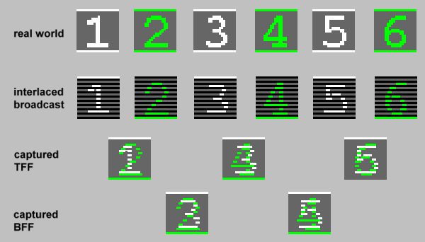

	We keep talking past each other. Let's forget about computer playback. The pixels are properly ordered in the pixel addressing to play in correct spatial position on the computer. The TFF vs BFF flag becomes an issue when the digital video is turned back into interlace video and RS-170A sync pulses are restored. The TFF/BFF flags indicate whether the first field presented to the NTSC/PAL encoder is a field one or a field two. If the flag is in error, the fields are placed in the wrong sync order and the result is vertical jumping during motion scenes when watching on an interlaced TV.Originally Posted by enbidia
	Here is a diagramOriginally Posted by enbidia
 Everything has been enlarged 3x for clarity.
 The first row is what the real world looked like at 6 consecutive points in time.
 The second row is how it looks during an interlaced broadcast. Fields 1,3,5 are a top fields and can be identified by the fact that the top-most scanline is contained in the field. Fields 2,4,6 are bottom fields and can be identified as such because the bottom-most scanline is included in the field. The black lines are the parts of the picture that aren't broadcast during the field. All standard definition TV is broadcast this way.
 The third line shows what happens when you capture top field first. Field #1 and #2 are packaged together to fill out a full frame. The same is done with fields 3+4 and 5+6. When this is broadcast as interlaced video again, the field order flag instructs the playback device to separate the two fields and output the top field first, the bottom field second. So the original order of the fields is preserved, 1-2-3-4-5-6...
 The fourth line is what happens when the video is captured bottom field first. The very first field (a top field) is skipped. Then fields 2 and 3 are packaged together into a frame. fields 4 and 5 are packaged togther. When the playback device outputs this to an interlaced display the bottom field is sent first, the top field second. Once again the original field order is maintained, 2-3-4-5-6...
	Thanks again for the clarification. I was thinking that since the codec is DV it will always by convention begin with the bottom field and the playback software option is only to assign whether to use the stored top fields or bottom fields as its bottom field for the playback. Never had I thought DV can be played back with TFF literally perhaps not the case if it is from a DV camcorder?
 Ok, what about when transcoded to MPEG which is TFF and using the fourth case above? Wouldn't playback become 3-2-5-4-7-6...?
