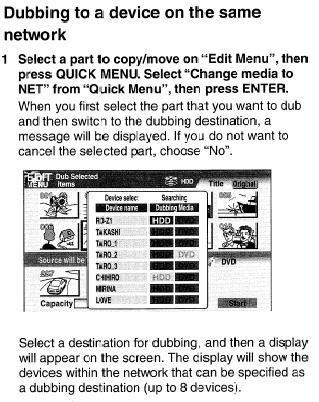

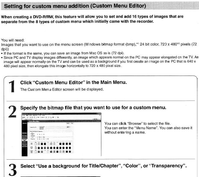

There seem to be several recorders that can do that via Ethernet but not Firewire or USB. The Toshiba XS54 and LG-519 are two of them.
The XS54 has a custom menu edtor as well. Here are a few captures from the manual about these two functions on the Toshiba.
Custom menus
Network dubbing
