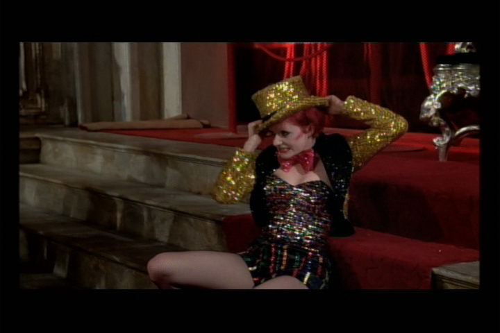

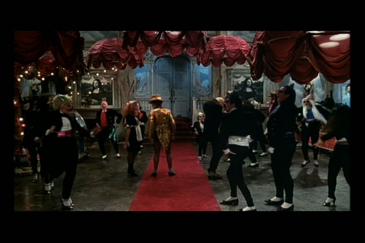

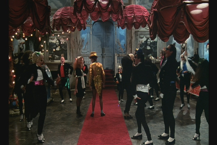

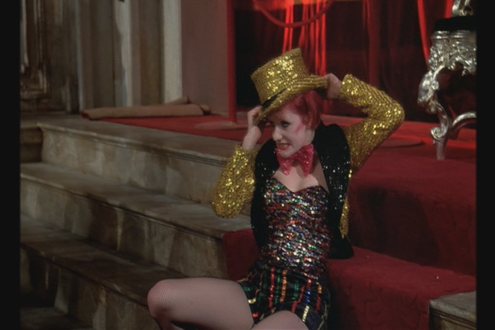

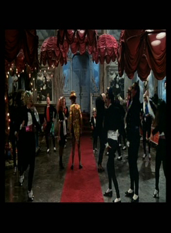

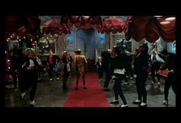

OK ... here are some screen grabs:
Original DVD Pic 01 (16x9 WS)
Original DVD Pic 02 (16x9 WS)
Pioneer XP - 1 Hour Mode Pic 01
Pioneer XP - 1 Hour Mode Pic 02
Pioneer SP - 2 Hour Mode Pic 01
Pioneer SP - 2 Hour Mode Pic 02
Pioneer MN15 - 3 Hour Mode Pic 01
Pioneer MN15 - 3 Hour Mode Pic 02
Pioneer LP - 4 Hour Mode Pic 01
Pioneer LP - 4 Hour Mode Pic 02
Pioneer EP - 6 Hour Mode Pic 01
Pioneer EP - 6 Hour Mode Pic 02
Recordings over composite will always look less sharp than original - using S-video would have produced better samples, I believe...also, by using 4:3 letterbox for recording and not true 16:9 anamorphic you practically upped the bitrate used for picture encoding since black bars top and bottom compress perfectly using up maybe just a few bits, so more bandwidth is available for the actual movie picture, making it look somewhat better than it would normaly be in most situations. I belive staying with original 16:9 anamorphic aspect would be closer to real world recording environment because the whole frame would be moving and wold be liable to be included in the bandwidth...nice effort though...congrats...
My PS2 came with composite video and I bought component video cables but had no S-Video. So I had to use the composite. The PS2 is the only DVD player I have now besides the recorder (normally I don't use the PS2 for DVD Video playback). You know you can't just plug in a regular S-Video for the PS2 and I wasn't going to buy the special PS2 S-Video cable just for this test.Originally Posted by Kalos Geros
Also I didn't record anamorphic because when do you use a stand alone DVD recorder to do anamorphic?
Hardly any cable or satellite boxes can output anamorphic to a stand alone DVD recorder.
I think my test is very valid.
Difficult to compare the 4 hr and 6 hr screen shots cos they're squished to half the size of the others.

Yes, that appears to be the case... the blacks are crushed in your caps. It is highly likely that the PS2 does not add 7.5 IRE of setup on it's video output (sends a 0-100 IRE gray scale signal instead of 7.5-100 IRE), so you would want to record with the Pioneer set to 0 IRE input video black level in this case. Same goes for recording from a digital camcorder using it's analog video output. The consumer MiniDV and Digital8 camcorders sold in North America don't add any black level setup to their analog outs, either.Originally Posted by FulciLives
Well that is why I made the test DVD ISO IMAGE FILE so people could download it ... burn it ... then watch it themselves.Originally Posted by cyflyer

It's not a limitation of the Pioneer as you seem to suggest but of the source material. Just is not much 16x9 anamorphic source material out there for stand alone DVD recorders UNLESS you record from DVD player to DVD recorder but I only did that to get a nice clean source and we all know that most DVD back-ups are of course done on a computer.
I used a DVD as my source so that I had a nice clean source to begin with ... I think starting with a clean source better shows the differences in recording modes.
Well I am of the understanding that most DVD players made for the US market do output standard 7.5 IRE BLACK and since my Sony PS2 is made by a major company and is a very recent model to boot (I just bought it new as of March 2006) I just assumed it would output 7.5 IRE BLACK.Originally Posted by gshelley61
However it does appear to output 0.0 IRE BLACK.
Had I know before hand I would of set the Pioneer IRE BLACK INPUT LEVEL accordingly so the recordings match the source.
However I think the test is still valid to compare the quality of the recording speeds vs each other.
I think that the way you have been going - 4:3 letterbox - is fine, for these
tests of yours. I don't see any problems for their intended purposes.

Interesting screen caps, although you should re-size them all up to 720x576 as this will give a better comparison of image quality. I assume that the "no cable/satellite box outputs composite anamorphic" must be a US thing, as all boxes do over here (they have to for feeding 16:9 TV's) and at least we don't have to worry about black levels. One other thing, have you noticed the way the Pioneers seem to introduce filtering for low bitrates, to avoid picture macroblocking. Even on very low bitrates my Pioneer won't macroblock, the pictures may look shite, but they aren't blocky!!
Well I captured the images as they were recorded. If someone wants to download them and compare them then the proper resize would be 720x480 as this is NTSC.Originally Posted by energy80s
