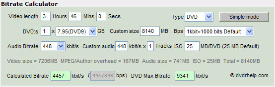

    For instance ... the movie is 226 minutes or 3 hours and 46 minutes long. The DVD has a 5.1 AC-3 audio track so I'm guessing that is at 448kbps as that is the standard bitrate for 5.1 AC-3.
    The VIDEOHELP.COM bitrate calculator
    As you can see you just need to re-encode uisng the parameters above. I would re-encode each disc separately then either join with TMPGEnc DVD Author OR join first (I use MPEG-VCR) then use TMPGEnc DVD Author (or any DVD authoring software).
    BTW to ensure that there is enough left over for the menu I would probably set the AVG bitrate at 4400kbps if not 4350kbps instead of 4457kbps ... so as to leave enough room left over.
