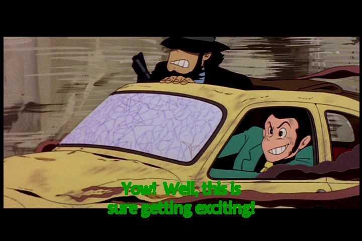

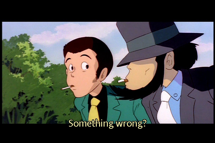

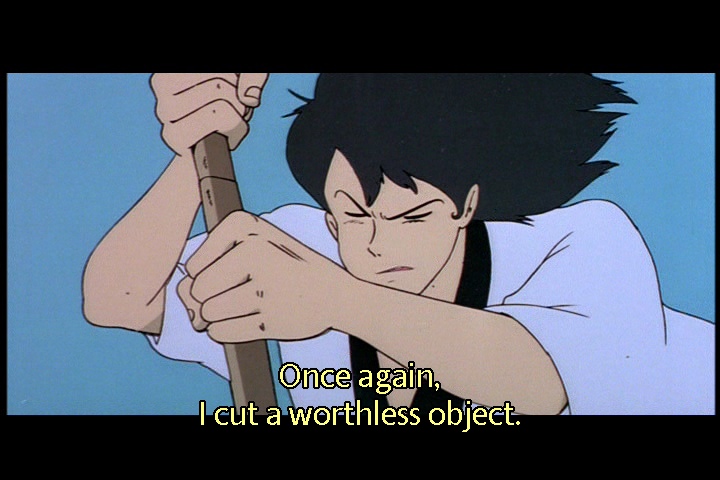

  5. The movie has the nice looking subtitle on the movie.
    But it change into green bulky type after the processing.
    How to specified this nice yellow thin fon on ifoedit ?
  6. Hey, Owe you another big one.
    Also, the other program can fix the packing error like ifoedit's VOB-extra is fixVTS.
    So, I have to conclude the subtitle get messed up when vobedit join the clips together. Right ?
