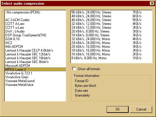

Okay, I was with you up until the compression part. I have no idea which audio compression I should be using, unless it's PCM. Here's my list.
You can use whichever codec you choose.
Me personally I would use AC-3 ACM 256kbps 48000Hz Stereo. Using this compression might make your file a bit larger than before. You can choose a lower bitrate if you want to save on some space. -
