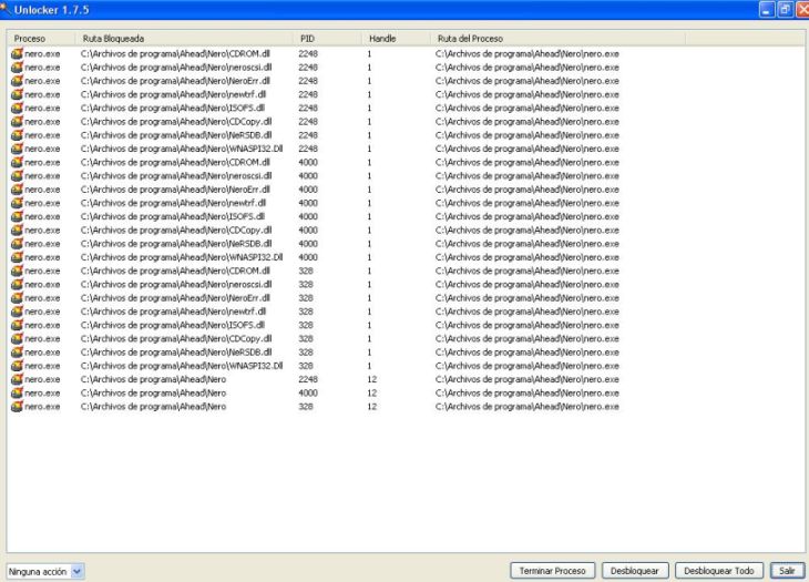

I’m sorry for responding after 5 days, I even had no time to take a screenshot to better explain my problem yet. So I will try to explain my best.
Guns1inger, your method worked just fine at work, killed the process and closed the app. I’m talking about Nero Burning Rom.
But did not work at home, which is where I have the problem. It started happening just of a sudden. I finished my burning session for the day, and closed Nero. Next day, Nero would no open, so I started looking what was the problem.
In task manager, Nero was not running as an app, but there were 2 processes running, both called nero.exe. I could not kill them from task manager.
Rebooted computer, and of course, it worked, but same thing next day. I have uninstalled and made a new clean installation of Nero for three times now, cleaning the registry after uninstalling, and it has not worked, either.
I tried unlocker, and this is what I’d like to screenshot but did not have time. Unlocker shows a window with about 16 nero.exe processes running, which are half pid 3042, for instance, and the other half pid 2680, and all of them point the path, duplicately, to several file.dll of Nero, I can remember copyDVD.dll right now. Not one of all this items can be killed.
By now, I’m not closing Nero from the last reboot
, can’t find a better way to fix this, since I don’t know what’s happening, neither much time to investigate.
If this makes sense to you, you may want to shed some light on me, or if this screenshot would help much, I’m trying to u/l it on weekend.
Many thanks
